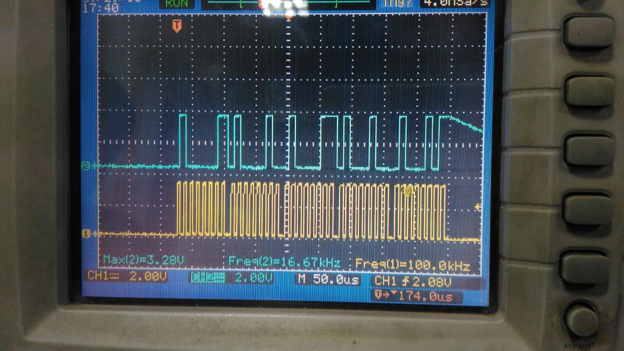

I have got the spi active and have tested the working of SCLK, MOSI and CS w.r.t  the program. While testing, I noticed some of the following issues such as:
1. The CS line and Clock signals are not synchronized
2. The data bits clocked out from MOSI are not matching with the actual data byte being sent
3. Sometimes, the data out is clocked out even before the start of the clock signal and I was wondering how can this be possible.
SPI configured for Bit Rate of : 100 KHz
SPI Sub Mode : 0 i.e. If I have understood it right -- The data is sampled on the rising edge of the clock signal and the data bit is clocked out during the falling edge of clock signal
SPI  Mode: MASTER
The FIG(1) below shows the image with the CRO output for the issue (1).
  FIG (1)
The Blue line is the CS signal and the Yellow one is the clock signal. As it can be seen in the CRO,  the start of the clock signal has been delayed a while later than the CS signal is triggered. Isn't the clock signal supposed to start as soon as the CS signal has been triggered?.
The FIG(2) below shows the CRO output that addresses the issue (2) relevant data mismatch. The Blue line is data line and Yellow one is clock signal
FIG (2)
In FIG (2), I have transmitted a character "A" i.e 0x0A. The expected data output bits supposed to be (MSB) 0000 1010 (LSB) in binary w.r.t the eight clock cycles shown above. However, form my perception of the signals, I  am getting some other data at the output and not 0x0A. Please let me know me if the data out what I am getting is actually wrong or I have interpreted the signals in a wrong way. This same issue applies to FIG (3) below as well when I transmit a character "B" i.e. 0x0B.
 FIG(3)
Just for more information, I am also attaching an image below in FIG(4), which show the transmission of 5 bytes i.e. "ABCDE"
 FIG(4)
The FIG(5) below shows the CRO output that addresses the issue (3) relevant data being generated even before the start of the clock signal. The Blue line is data line and Yellow one is clock signal.
 FIG(5)
In FIG (5), I have transmitted a character "F" i.e 0x0F. The expected data output bits supposed to be (MSB) 0000 1111 (LSB) in binary w.r.t the eight clock cycles shown above.  Here too, I am getting some other data as well as , it can be seen that the data out is clocked out before the clock signal and there is not sync between the clock and the data.

  • Ok. I have understood that characters are sent as ascii formats. However, still did not understand w.r.t to Fig(5). How the data is being clocked out even before generation of the clock signals ?. And sending data 0xF0 in hex using the below
    MAP_SPITransfer(GSPI_BASE, (unsigned char*)0xF0,0,bytecount, SPI_CS_ENABLE|SPI_CS_DISABLE);
    is not giving the appropriate output i.e. b0000 1111.
  • Its all working good now. Successfully being able to send bytes using SPI , hence I am closing this thread.
