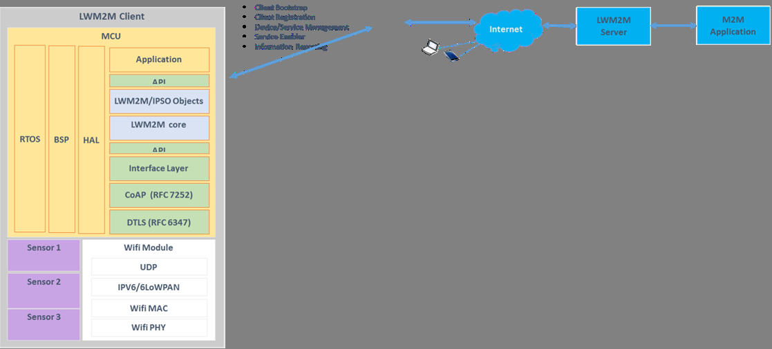

We are looking for a development/reference platform for LWM2M networks.  What does TI have/provide to support this new development?
~Leonard
  • Currently, LWM2M is not ported to CC3200 platform and there are no plans to port in near future. Since, this appears like a high level application protocol, on top of UDP (with no device dependency), i suggest end user to port it them selves and seek forum support for any porting issues.
