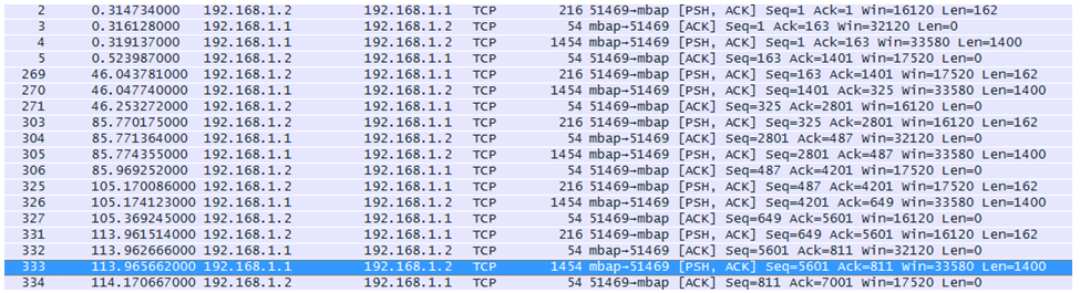

<TCP Wireshark Capture>
Speed is also a problem, but a strange one more point.
269. PSH ACK ( PC->CC3100(Receive) )
270. PSH ACK ( CC3100(Send) -> PC )
271. ACK ( PC -> CC3100(ACK) )
total 210ms
303. PSH ACK ( PC->CC3100(Receive) )
304. ACK ( CC3100(ACK) -> PC )
305. PSH ACK ( CC3100(Send) -> PC )
306. ACK ( PC -> CC3100(ACK) )
total 200ms
ACK Frame This is not regular.
The same result came out above.

  • Hi Cho,
    It looks to me like that your PC is waiting 200 ms to ACK the packets from the CC3200, right?
    Perhaps there are some server setting to be changed on that end?
    Also, try seeing the throughput when the CC3200 is doing all of the sending, or all of the receiving
    -Aaron
  • Hi Aaron.
    Note has your answer.
    I had to solve the above problems.
    "Delayed ACK" function was being used on a PC.
    Did not use the "Delayed ACK" TCP speed comes less than 3ms.

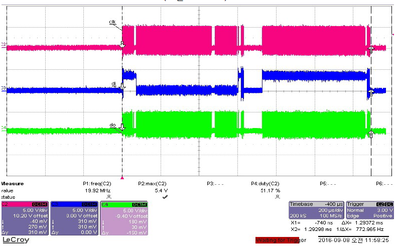

  • Hi Aaron!
    First, the server(CC3100) to upload the settings to a file.
    I had made the experiment by setting an example.
    Second, the TCP communication photos using an oscilloscope.
    In the above picture proceeds to receive the next transmission.
    CC3100 MCU data transfer at up to a total of 1.3ms.
    However, Wireshark takes about 3ms ~ 4ms.
    I also believed that the delay in this part of the CC3100 Flow.
    What do you think?
