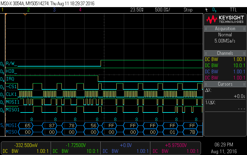

Hi all,
we are working with CC3100 module and SPI with SDK 1.2 and ServicePack_1.0.1.6-2.6.0.5. After some message CC3100 stop answer correct sync sequence
as shown host correctly send 65877856, to ack Irq. So module deassert IRQ line, but the module don't send correct BDDCCDAB sync word.
Any idea ?
