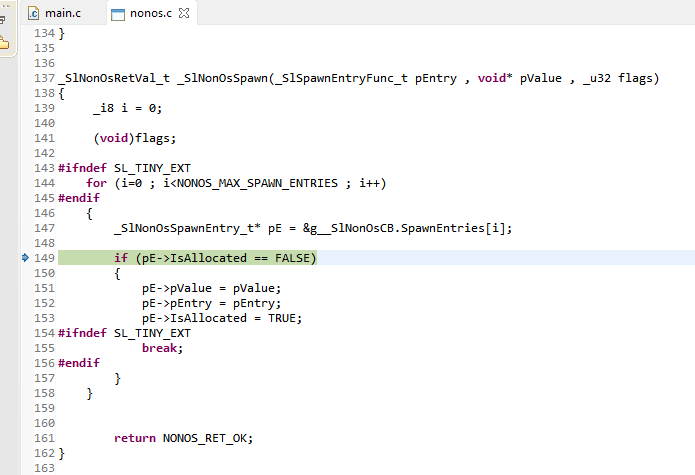

    You are sending udp packets using sl_ API directly from timer interrupt? I think this way can't work properly.
    You need save samples achieved from timer interrupt into buffer and outside ISR read values from buffer and send it via UDP.

  • Hello Ben,
    We did try sending a fixed angle value and are seeing similar results (sometimes we are able to acheive a slightly higher frequency). I've pasted the code snippets below. As you can see the program flow is very similar to the UDP demo application. Instead of filling a buffer in the BsdUdpClient function, we create the UDP socket and enable a timer. The BsdUdpClient function then enters a while loop until the required number of packets have been sent. The timer ISR then sends each UDP packet and increments the packet timer. Once the while loop exits, the timer is disabled and the socket is closed.
    When the program hangs, it never finishes sending all of the required packets. When we click pause on the CCS debugger, the carrat points to functions within nonos.c (picture attached).

    Using sl_ API calls in ISR will not work properly. If you not want issue, don't try do that.
    Jan

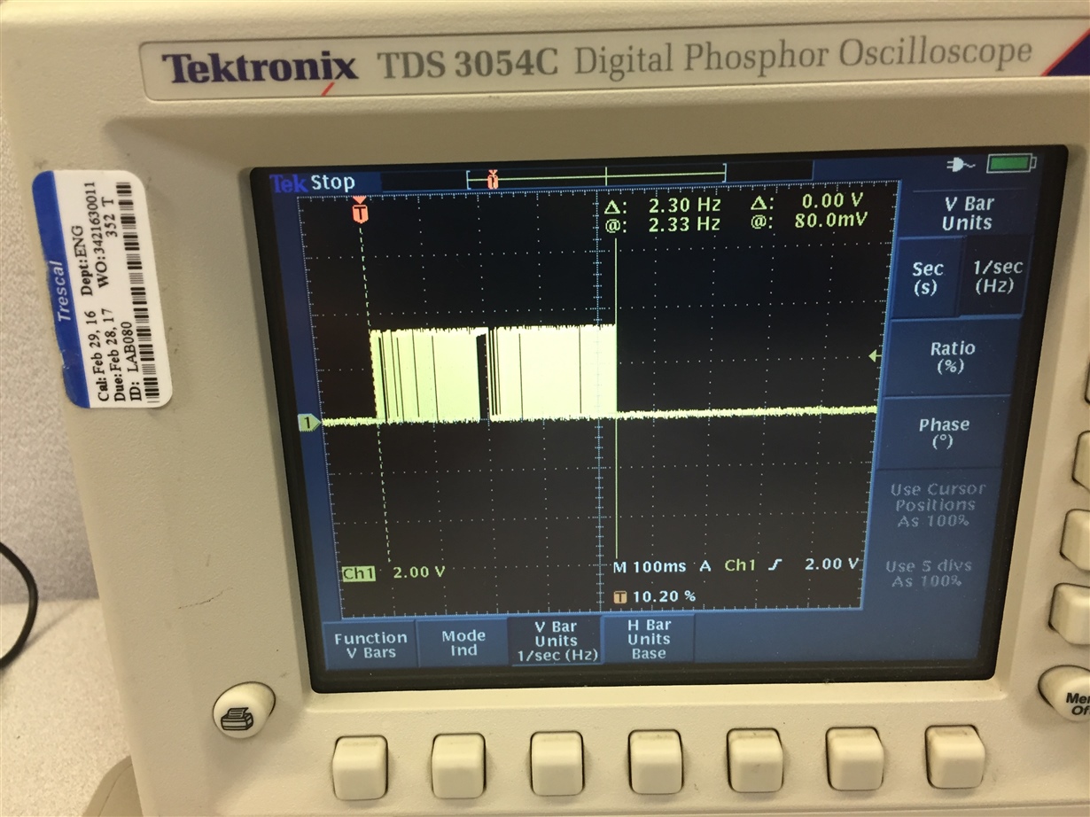

  • Hello Ben,
    As far as I'm aware the wireless network should be close to optimum. The router is inches away from the demo board and shows 99% signal quality. I'd be happy to describe the modifications we made. We've also done some additional testing as follows:
    TCP demo application:
    1) Updated pinmux and main.c to toggle green LED and another GPIO pin during while{} loop used to send packets (loop in BsdTCP/UdpClient)
    2) Adjusted packet size to 8 bytes. We were able to send 1,000 TCP packets with a time period corresponding to roughly 2 Hz (so average of 2kHz frequency per packet).
    We performed the same test using UDP, which resulted in an overall average packet frequency of 2.5 kHz. These are both far below the  stated application throughput of 13Mbps and 16Mbps accounting for packet header / minimum size.
    3) Increased packet size to 80 bytes with UDP. We saw a similar average packet frequency of 2.3kHz (see image, 1,000 packets in 2.30Hz- notice the large delay).
    Thoughts:
    1) Ideally we’d like to see a more uniform packet spacing / timing for our specific application, but I believe we can accommodate the irregularities we’re seeing.
    2) The stated application throughputs of 13Mbps and 16Mbps should apply to both small and large packets. We may be able to develop a workaround by transmitting larger packets to achieve our desired throughput, but the preferred solution would be to have smaller packets with a faster packet rate.
    3) Can you clarify what happens if an ISR is triggered while a previous ISR is running? Does the new ISR wait to execute until the first one completes, or is the first one interrupted and put on the stack until the new one completes?
    We appreciate any help/insight TI can provide. Here's the updated while{} loop code to toggle the LED and GPIO pin:

    Here's the UDP scope capture for 1,000 80bit data packets:
  • Hi Nicholas,
    You will not be able to reach the optimum performance just using the Launchpad.
    I'm confused as to how the timer is being used with the current loop. Does the timer trigger the while loop which runs to completion and then starts over after another timer interrupt or have you removed that functionality from the test? Are you using a blocking or non-blocking socket?
    Note that the sl_Send() function does not indicate when the data has actually been sent by the device, but rather when the data transfer to the networking subsystem finishes.
    Try checking the actual data throughput using a utility like iperf. I recommend also capturing network logs to understand what is happening and see all traffic.
    Regarding (3), the second ISR should wait to be handled until the first routine completes.
