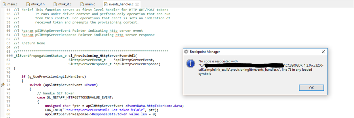

I believe I have found a bug in the provisioninglib that prevents use on FreeRTOS systems. During normal operation, a call to
lRetVal = sl_extlib_ProvisioningStart(ROLE_STA, &cfg);
as done in the provisioning_ap example from the SDK v1.2, will command the provisioninglib to take over all HTTP callbacks, so that it can communicate with the smartphone app. This does not happen, however, when ported to a FreeRTOS system. To show this, I have imported the out_of_box example project from the SDK (since this example uses FreeRTOS) and only slightly modified the main code to call the provisioninglib instead of calling smartconfig. I will attach a copy of my modified main.c file, but below is a summary of the modifications I made to the main.c file that comes in the oob project:
  1. Add include statements for provisioninglib (copied from provisioning_ap example)
  2. Copy startProvisioning() from provisioning_ap example.
  3. Copy sl_extlib_ProvWaitHdl(_i32 timeout) and modify to use osi_Sleep(1);
  4. Copy sl_extlib_ProvEventTimeoutHdl(_u8* event, _i32 timeout);
  5. Replace call to SmartConfigConnect() with call to startProvisioning()
  6. Link to provisioninglib project with "SL_PLATFORM_MULTI_THREADED" defined
  7. Rebuild provisioninglib
  8. Build oob project.

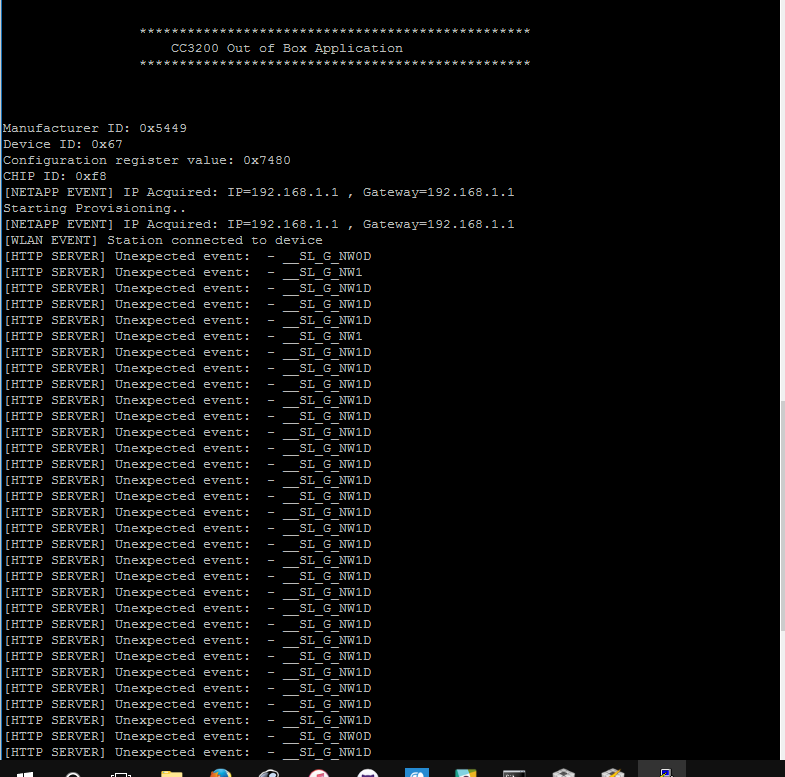

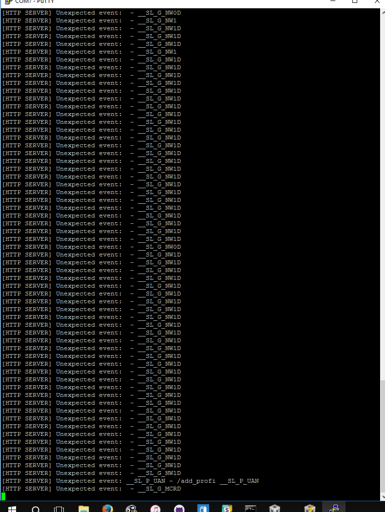

The project builds fine, however when I go through the provisioning process, none of the HTTP server callbacks are handled by provisioning lib, and are instead sent to the callback function defined in the oob main.c file. To prove this, I added a few simple lines of debug code to the HTTP server call back to output all the HTTP GET and POST requests that go un-handled. Below is the debug code I added to SimpleLinkHttpServerCallback():
void SimpleLinkHttpServerCallback(SlHttpServerEvent_t *pSlHttpServerEvent,
                                SlHttpServerResponse_t *pSlHttpServerResponse)
	// DEBUG FOR PROVISIONINGLIB BUG
	char token_name[10];
	char token_data[10];
	memcpy(token_data, pSlHttpServerEvent->EventData.httpPostData.token_name.data, 10);
	memcpy(token_name, pSlHttpServerEvent->EventData.httpTokenName.data, 10);
	UART_PRINT("[HTTP SERVER] Unexpected event: %s - %s\n\r", token_data, token_name);
	return;
	// \DEBUG
Below is a screenshot of the console output after running this app with the debug code:
As you can see from the pictures above, the HTTP SERVER events are not getting handled by provisioninglib as they should be. We have a product demonstration to a large customer in a few weeks, and this bug is causing our FreeRTOS system to fail.Please help release a solution to this ASAP!
	return;
	// \DEBUG

    I am trying to understand whether the AP provisioning example is working as-is. Is it?
    It seems that the provisioning external library is not compiled and linked and I want to verify it.
    If you place a breakpoint in sl_Provisioning_HttpServerEventHdl()@Events_handler.c, is it working?
    Shlomi
  • Thanks for your quick response, Shlomi.
    Yes, the privisioning_ap example works as is. This is because it links to the precompiled provisioninglib.a file stored in the SDK. This precompiled library only works for NON-OS systems though, so I need to rebuild provisioninglib with multithreaded enabled for me to use in FreeRTOS. I think it would be better if the SDK included a version of provisioninglib.a that is compatible with multithreaded systems as well. This would save a lot of time and trouble for others trying to get started with the provisioninglib.
    I will test putting a breakpoint there and see what happens. I will post my findings ASAP.

  • Shlomi, when I try to insert a breakpoint in Events_handler.c, it gives me the following error stating that the code is not used in my project:
    This leads me to believe that this function gets removed from provisioninglib after compilation when compiling for multithreaded systems... Do you know why this would happen? It seems very much like a bug..
  • Hi John,
    The network_common.c file included in the Out-of-Box example will make the application bypass the event handlers implemented in the provisioning library.
    I believe you will have to remove this file to enable a project to use the handlers in the library.
    Ben
  • Good find, Ben. I removed the network_common.c file, and things are working again. Thanks!
