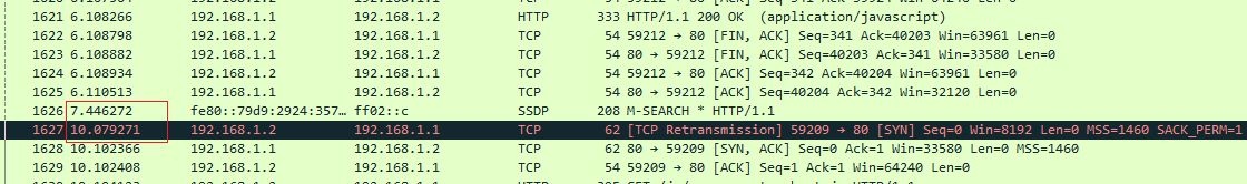

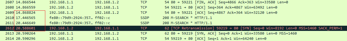

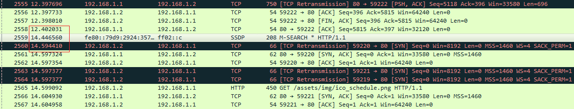

    Another day of my investigation. What i see in Wireshark is TCP retransmission occurances durign delays between two HTTP requests. Screens below:
    PM

    I reviewed the sniffer logs and the latest retransmissions that you see.
    SimpleLink device network stack has built in limitations since it is running on embedded system with limited resources after all.
    You can have up to 7 sockets where the memory you can use for packets allocation is also bounded (you can see from the TCP window size).
    Buttom line, in your case you open several connections simultaneously as can be seen on sniffer.
    Each connection that is openned is followed by SYN packet sent to the SimpleLink device and the devie should respond with SYN packet back. At the end of this handshake, the host can call sl_accpet() and get a valid socket descriptor back. When the handshake is not done, you would get -11 and you should retry.
    This is what happen in your case, since you are trying to open many connections at the same time, and the chrome starts counting from the 1st SYN that is sent by the browser, it happens that not always the SimpleLink can fulfill the connection and the browser needs to retry (as it does).
    This is why you see the retransmission. The timeout between retransmissions is browser dependent but eventually you see that it suceeds.
    I hope it adresses your questions.
    Shlomi
