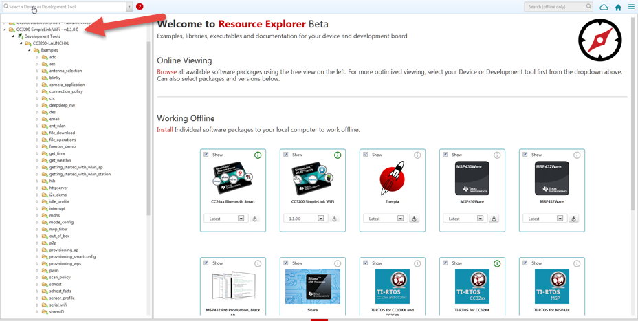

3) Why the SDK examples aren't show in the CCS examples tree view? I can see only Driver, Instrumental and Kernel examples

    3- The SDK examples are shown inside the "Resource Explorer" but you need to choose from the root folder "CC3200 Simplelink Wifi". At least they are in my CCSv6.2.

  • Resource Explorer was introduced in CCSV6.2, it was not available on earlier versions.
