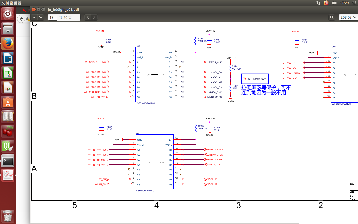

Hi,all
I have working on WL1835 wifi module. Found no interface wlan0 in the load driver .After loading it shows some error log like below.

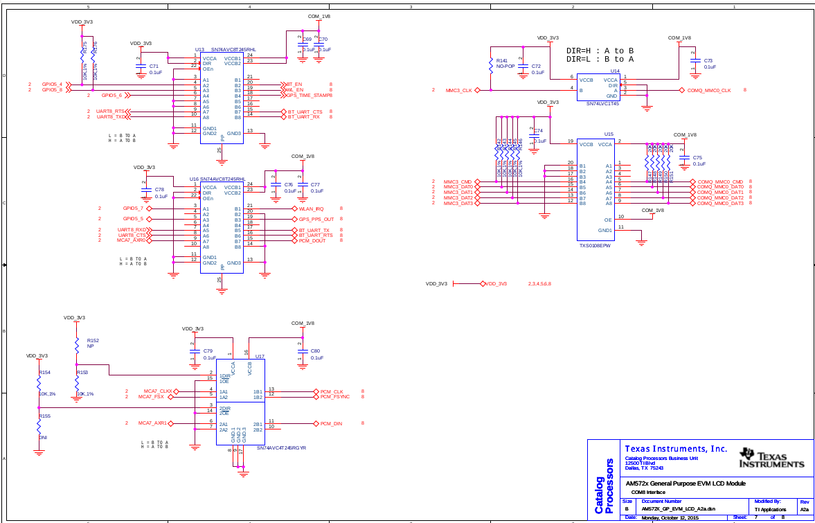

I have verified voltages, Vbat:3.1v and vio:1.7v and WL_EN is 1.7v.

In addition, my WL1835 driver is the official used to own , If the driver can support provided by the official of my system . About this drive I am a official used to own or compat-wireless .
please help me it is hardware issue or software issue.

    1. What is the board you are using, is it an am57xx-evm or you own target hardware?
    2. Can you paste the full kernel boot log (from power up)
    3. Please attach your full kernel .config
    BR,
    Eyal

  • Dear Eyal,
    Thanks for your reply.
    I use the level shifter model is LSF0108QPWRQ1.
    Here is my schematic :
    Is there any problem with this connection?
    Thanks.
    Normally, you should have used TXS0108. This is what most designs use, and as shown in:
    www.ti.com/.../swra448a.pdf
    I have forwarded it also to our H/W expert to comment regarding the feasibility of using the LSF.
    BR,
    Eyal
  • Dear Eyal,
    Thank you for forwarding, I will wait for your H / W expert advice.
  • Some suggestions from our hardware team:
    1. Scope the SDIO lines and take snap shots at several clocks
    2. Try to pull the sdio lines with a 10k resistor to 1.8V on the WL8 side with existing LS (D0,D1,D2,D3,CMD) and take snap shots again
    3. If it doesn’t work Try to replace with the TXS0108 Variant and measure again
    BR,
    Eyal

    The best suggestion I have right now is to try and replace the LSF0108 with the TXS0108.
    This is the LS that most customers use.
    Otherwise you need to probe all the sdio lies using an oscilloscope a during sdio bus operations and check the signals.
    There is not much we can say without actually seeing the wave forms.
    BR,
    Eyal
  • Hi Eyal.
    I can refer to the EVM design?
    Below is the circuit schematic.
    Why WL_EN, IRQ, CLK and CMD  、D0-D3 to use a different chip .
    Can not they use the same TXS0108 conversion?
    Or is it because these signals affect each other?
    Thanks.
    Yes, they can use the same TXS0108.
    See for example the beaglebone black wireless board schematics for reference.
    github.com/.../BeagleBone_Black_Wireless_SCH.pdf
    BR,
    Eyal
