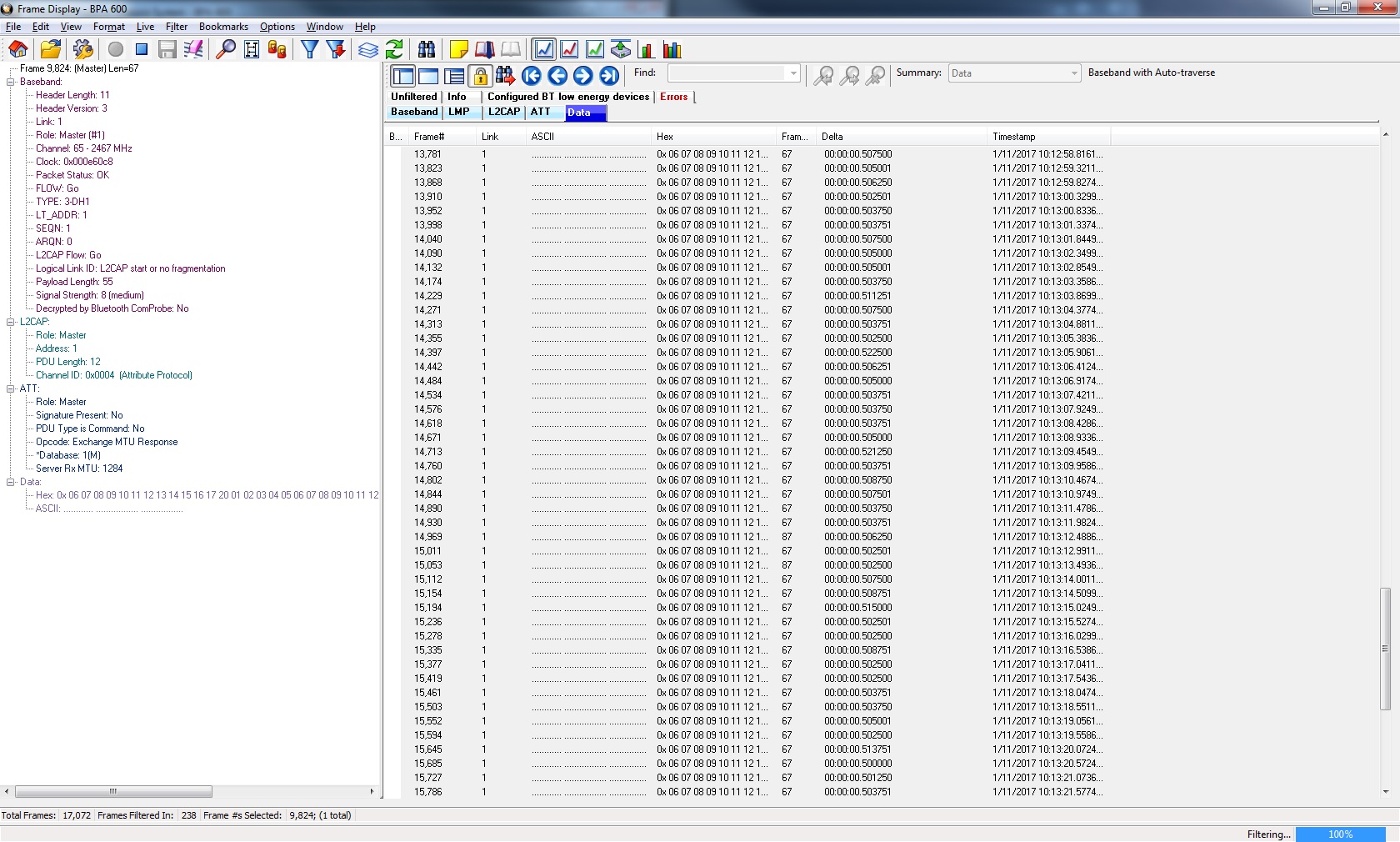

  • Now I have done some FTS logs for you. I have used the virtual sniffer for HCI logging and I have sniffed the air with my Frontline Bluetooth sniffer. All logs are available here: drive.google.com/.../0B55ZqKqlP6i-dXVzb2o0bk5haGM Please let me know if you find issues with the link.
    The files named xx_cap_flowspec.cfa shows the behavior when using the FlowSpecification HCI command, the xx_qossetup.cfa when using the Qos Setup HCI command. I have also sent to you a HCI and air log where you can see our latency problem, which is really our greatest problem. I don't know if you can give any tips there though since you cannot really see anything strange in the log where we have the delay. The delay only occurs for short packets sent from Master to Slave. In the air capture you can see the delay on frame 11162 and in the HCI log on frame 815.
    Thank you so much for your support.

  • OK thank you for your reply and for taking your time. Then I know there is no obvious explanation for the delays. Right now I have only the possibility to make a virtual trace for the HCI commands unfortunately. We will try to investigate even more if we can find a host issue. I will get back to this thread if new questions comes up.
  • I have uploaded two new files in this folder. Please have a look.
    In the attached log files deviceB-master and deviceB-slave, 100 bytes of data was sent at a frequency of ~400 ms from device A. In the air sniff log you can see that the packets are sent in a regular basis from device A but the time between two adjacent packets in the receiving side is fluctuating when device B is acting as slave. The only difference in the two test setups is the master/slave role of the device B.
    We cannot find any explanation for this behavior and hope that you can help us to find the root cause.
    Thanks for your time!
  • Hi Hanna,
    I looked at the air trace, and indeed I could see that slave is receiving LE data packet every 400ms.
    To pinpoint the issue, HCI capture (not virtual) is a must. I could start adding traces in the FW, but I find it redundant as it could be anywhere, and will also not prove anything (could still be host or controller's issue). Once you provide HCI capture which proves it's a controller issue, I could start working on this issue from controller's/FW point of view.

    The FW logs seem fine.
    I'm sorry, but I don't see how we can proceed without UART sniffer. Once the UART sniffer proves the issue is with the controller, I will be able to start adding traces in the FW code (will require new initscripts).
    Tomer
  • Hi again,
    We tried with a 115.2k baudrate on the HCI UART and could not see the behavior. Could you try with 3Mbit/s on the HCI UART since this is what we have in our embedded system?
  • Hi Tomer,
    Just a reminder, have you been able to try this with bigger HCI baud rate?
    Ramtin
    I will only be able to try this out next week. Have you had a chance to get  UART sniffer?
    Tomer
    Ok, thanks. I haven't got a module that I can connect to the HCI UART yet, we're working on it.
    You should be able to reproduce it with 3Mbit UART since everything else seems to be the same in our set up.
    Ramtin
  • Hi Ramtin,
    I've been able to reproduce the issue with baud rate of 3Mbps. I'll be looking into it to see whether it's a bug, or can be fixed by a different configuration of the device.
    As a workaround, are you able to work with 921600Kbps? You will not experience this issue.
    Tomer
  • Hi Tomer,
    Good news that you can reproduce it on your side and hope there is an easy fix to it.
    I still see too long delays with 921600 and some packet sizes, with 460800 it gets ok. However we need at least 2Mbps in our product.
    Ramtin
  • Hi, just wanted to hear if you have come closer to a solution or anymore findings?
  • Hi Tomer, just wanted to hear if you have come closer to a solution or anymore findings?
    We're still looking into this.
    Can you explain again why you disable EDR3? As I understand, the issue doesn't occur when EDR3 is enabled.
    Tomer
    We get worse range with EDR3.
    However the issue also occurs when all packet types are enabled, it depends on how big the l2cap data packet is and how much the baseband packet is filled with data. For instance if the payload in the air is about 110 bytes you get best result if DM3 is carrying the data.
    After what I have experienced if the chosen base band packet type is filled with more data (>60% of its maximum capacity) there is less latency problems. Also if you send the data with less delay between two consecutive packets (<100 ms) you'll see less fluctuation in the latency. It feels like some sleep policy or rescheduling is kicked in these cases.
    Ramtin
    We're still looking into it, but I'm not sure we'll be able to address this issue assuming it's caused by the MAC/HW layer. I'll keep you updated.
    Tomer
  • Hi Tomer,
    Have you had any more progress today?
    It's currently being investigated by the HW/System design team. I don't have any update at this stage.
    Tomer
    I have two workarounds you can use, and this in fact clarifies why we haven’t been able to see the issue in the past 10 years.
    The default mode of the controller should be working in sleep mode (Send_HCI_VS_Sleep_Mode_Configurations 0xFD0C), otherwise current consumption would be much higher. There’s no reason not working in HCILL mode (sleep mode). The controller will strive to enter this mode autonomously whenever possible. The host must comply though with the HCILL protocol ()
    Another point is that whenever there's an ACL connection with low or intermediate throughput, the host should strive to have the connection in sniff mode. There's no reason to have an active connection as it will consume much more current consumption.
    By working with low sniff interval, I haven't seen the issue, or when working in HCILL mode.
    Tomer
