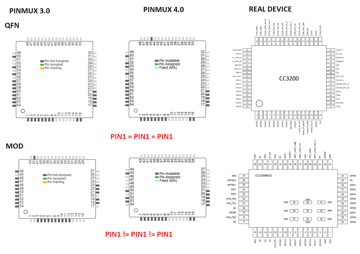

  • Hi Sarah,
    From my point of view this is not important for me. I have no problem deal with that.
    I think biggest confusion comes from wrong pin layout image which is in web version. If pins are assigned from QFN point of view, there need to be QFN image and in this case, it not make sense to have MOD package in web pinmux...
    You can compare:
    Jan
  • In this sense I certainly believe Jan is right. Regardless of what calls to to PinTypeUart() the tool generates, when I select the MOD package type, the tool should allow me to configure UART1 to use *MOD* pins 46 &47. Which should generate the following code snippet taken from the previous version of the tool:
    // Configure PIN_55 for UART1 UART1_TX
    PinTypeUART(PIN_55, PIN_MODE_6);
    // Configure PIN_57 for UART1 UART1_RX
    PinTypeUART(PIN_57, PIN_MODE_6);
    Right, those correspond to the chip pins which map to 46 and 47 on the MOD. Cool, no problem. *However*, the version of the tool released on 12/19/16 *does not* allow the assignment of 46&47 when the package type is MOD. The tool should allow assignment from the selected package types perspective. Otherwise, why even have that option in the tool?

  • Hi Dallas, Jan,
    Thank you for the input. We are working with the PinMuxTool to remedy this from the previous version. My concern in this thread was being sure we understood that it did not affect the MOD layout, which may have gotten us off-topic a bit.
    I can post a timeline here for the tool fix when I get it. In the meantime, the previous version 4.0.1223 is available as an offline installer on the wiki: processors.wiki.ti.com/.../TI_PinMux_Tool
    Sarah
  • Hi Dallas, Jan,
    A fix has been added to dev.ti.com. The fix for the offline version should be added by the next revision release.
    Sarah
