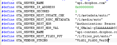

    My actions to fix it:
    SDK 1.3.0
    1. Recompile ota with debug print options:
    1.1 in ‘extlibs_common.h’ uncomment #define DEBUG_PRINT
    1.2 check #define OTA_DROPBOX_V2 is not commented in OtaCommon.h
    2. No changes in firmware in OTA field (below are constants worked fine on v1):
    #define OTA_SERVER_NAME                 "api.dropbox.com"
    #define OTA_SERVER_IP_ADDRESS           0x00000000
    #define OTA_SERVER_SECURED              1
    #define OTA_SERVER_REST_UPDATE_CHK      "/1/metadata/auto/"
    #define OTA_SERVER_REST_RSRC_METADATA   "/1/media/auto"
    #define OTA_SERVER_REST_HDR             "Authorization: Bearer "
    #define OTA_SERVER_REST_HDR_VAL         "my token here"
    #define LOG_SERVER_NAME                 "api-content.dropbox.com"
    #define OTA_SERVER_REST_FILES_PUT       "/1/files_put/auto/"
    #define OTA_VENDOR_STRING               "Vid01_Pid00_Ver0000"
    3. Debug print from UART:

  • Please change your OTA_VENDOR_STRING like below.
    #define OTA_VENDOR_STRING "Vid01_Pid00_Ver00"
    Then rename your dropbox folder to "Vid01_Pid00_Ver00_02090000"
    Then try again.
    Let me know the results.
    -- Javer

  • agh.. the same error:
    firmware:
    Folder structure:
    UART debug:
  • I'm quite convinced that the only item need to correct is the folder name and the OTA_VENDOR_STRING.
    See good logs on my application. Don't bother about the v1 api call, it seems to be a uncleaned debug log.

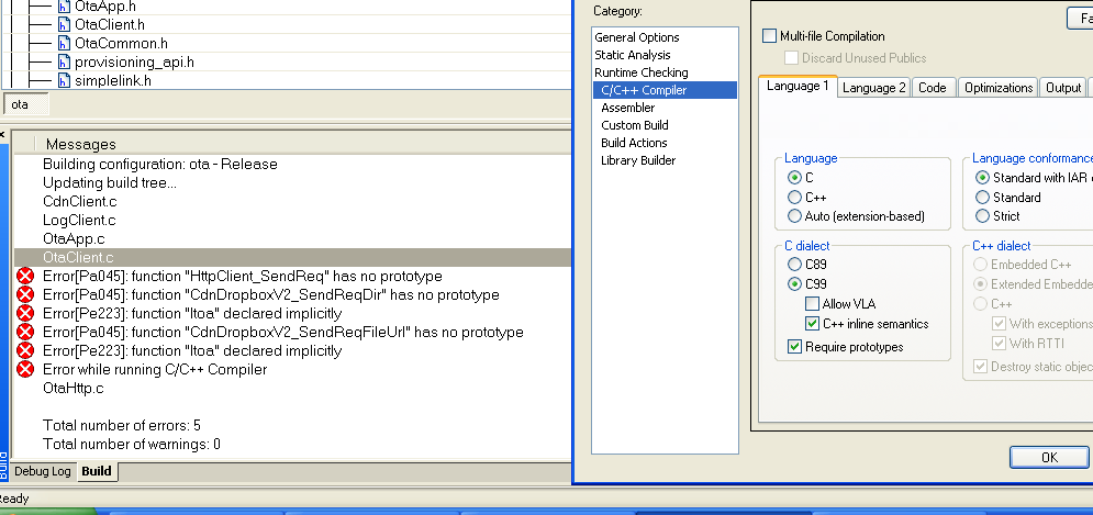

  • Also, one possible reason for the issue.
    I use IAR ARM 7.70 to recompile CC3200SDK_1.3.0\cc3200-sdk\simplelink_extlib\ota
    During compilation, I get an error (no files with definition ltoa):
    So, I uncheck "Required prototypes" and compile the library successfully. But to compile the library with my firmware I use ltoa from here (just first I found on github itoa.c): #mce_temp_url# could it be the problem? And where is the itoa.h/c fir IAR version of the project? <stdlib.h> do not satisfy, so I use 3rd party.
    From the other hand when I use original precompiled ota library from the SDK1.3.0 for iar, the same issue continues with dropbox.
    So, at the moment after help from Javer (thanks a lot for waste your time!) I got:
    1. Dropbox requests on curl is as need
    2. After rename folder on dropbox side to "Vid00_Pid00_Ver00_02090000" and assign #define OTA_VENDOR_STRING  "Vid00_Pid00_Ver00" the issue is still here
    3. at the same time Javer's code works and it was compiled in CSS
    So, seems the only difference is compilation IDE? Could TI guys try to compile OTA in IAR and check with current Dropbox api?
    Thanks!
