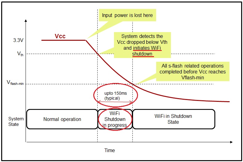

For ensuring the integrity of the power supply to the serial flash,
we want to connect a capacitor to the outside and slow down the voltage drop of Vcc.
I have two question about following wiki page.
http://processors.wiki.ti.com/index.php/CC3100_%26_CC3200_Serial_Flash_Guide
Q1:
What should we do with "initiates WiFi shutdown" in the graph?
Should we call sl_stop? Is there any other processing required?
Q2:
"WiFi Shutdown in progress" is described as "upto 150ms(typical)"
What is the maximum value of this time?
If it depends on the system, how should we estimate this time?
