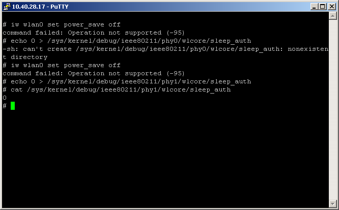

  • Hi Lumir,
    Before we start digging deep into your logs, can you srart with your Q6 (disable ELP) using the following procedure:
    And see if the issue is still seen?
    I want to see if this missed interrupt is by any chance after wake up from ELP.
    Eyal
  • Hi Eyal,
    I tried to disable power save mode according to your reference:
    Command "iw wlan0 set power_save off" is not supported in AP mode. However, second setting was successful.
    Unfortunately the behaviour is similar. The missing TX interrupt is still here. In new attached kernel log file you can see it at 3014853793 time stamp and later.
    Some more information I forgot to mention: I have set debug_level = 11361, it means IRQ + EVENT + TX + PSM + MAC80211 + ACX, in kernel driver.
    wifi2.zip
