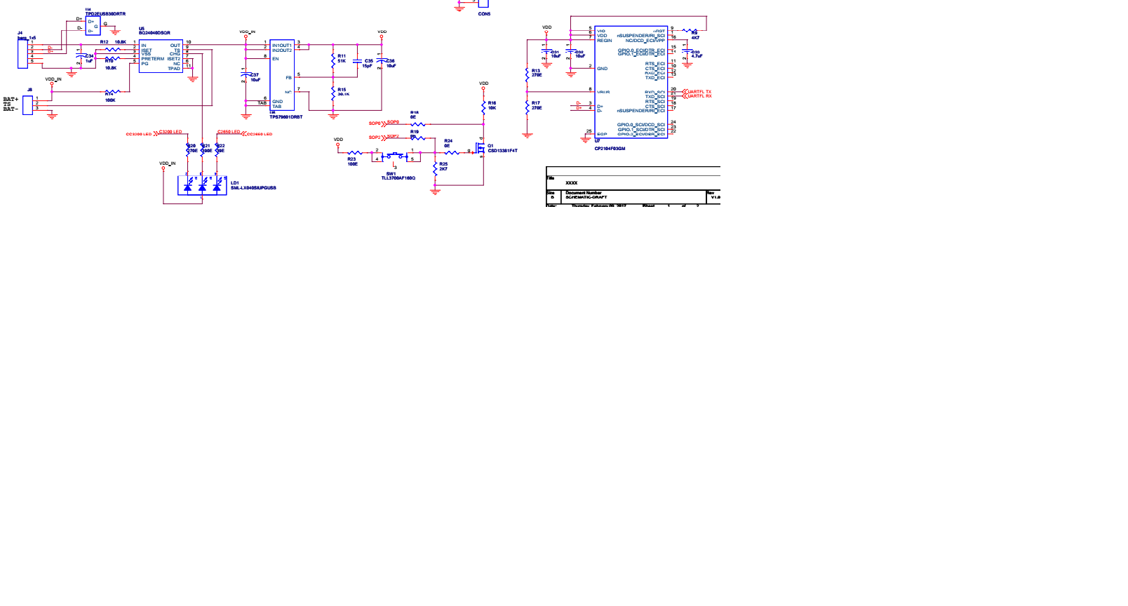

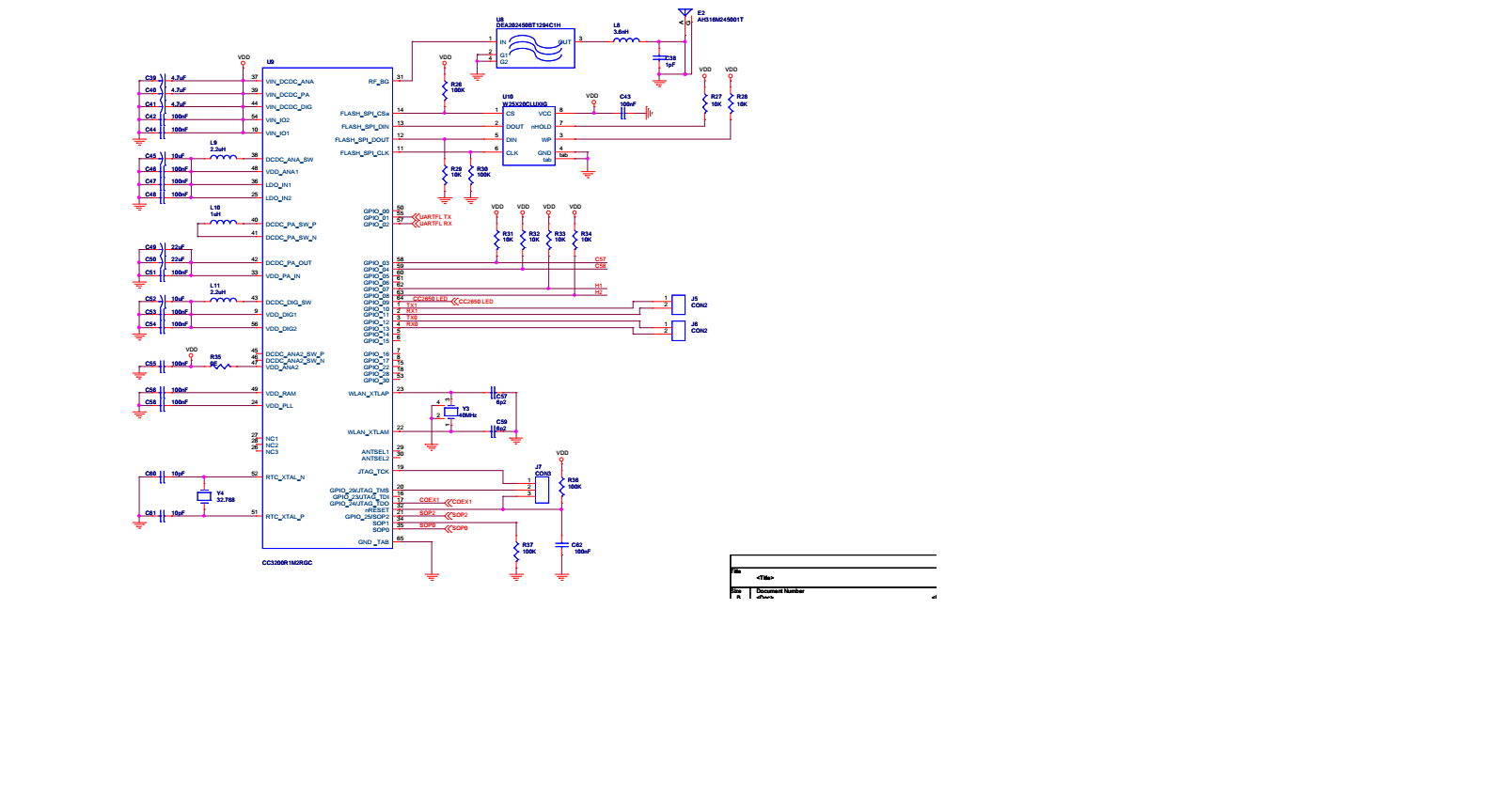

  •   Hi Jan,
    Attached is the schematic images for my custom board for CC3200.Please have a look at help me to program my board using uniflash software.
    I have CC3200 Launchpad as well as smart RF06 board.
    Please guide me .
    Thanks & Regards,
    Shashank
  • Hello Shashank,
    Procedure here to flash should be :-
    1. Power Up board and connect USB.  USB->UART should enumerate as COM port.
    2. Start Uniflash, configured for CC32xx serial connection and set the appropriate COM port.
    3. Start a 'Format Operation'.  Console will prompt to 'Reset Target'
    4.  When prompt is seen, hold down SW1 (which should set SOP2=1, and SOP0=0, for UART load mode), and while SW1 is pressed, assert a low pulse on the RESET line (J7, pin 3) to latch the SOP pins and start UART loading mode.
    5. Uniflash should continue to FORMAT the device.
    6.  After that, you can program a service pack, etc.
    [ If this doesn't work, please check that the SOP pins are being set correctly by the SW1 logic, and that the reset signal is good, and check that the USB->UART is working with a terminal program, by potentially looping back  UARTFL_TX/RX ].
    Hope that helps,
    ~roger

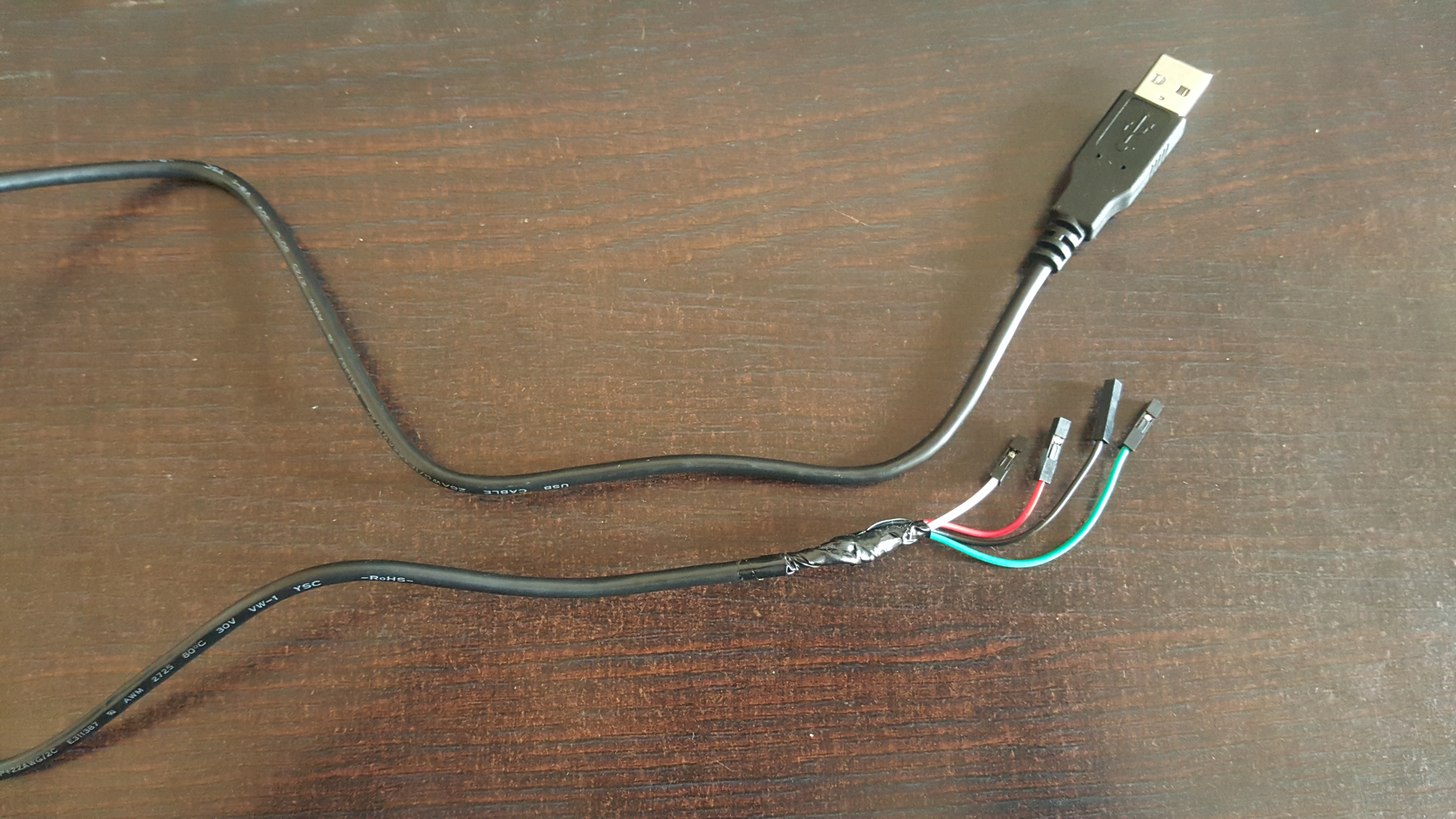

  •  Hi Roger,
    Thanks for the procedure but here Com port is not displayed on my device manager.
    Also, In my hardware instead of USB Port I have berg strip  as tagged as J4 connector (as referenced with above schematic).
    Currently,I'm using Usb cable in that 1 end is having usb port and other end is having female jumper which I attached to J4.Attached is the image.
    Thanks & Regards,
    Shashank
  • Hi Jan,
    I tried the same appproach as roger mentioned.But i unable to see my com port in device manager.What's going wrong ?
    Thanks & Regards,
    Shashank
  • Hi Roger,
