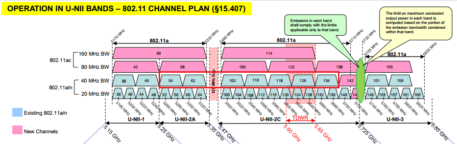

We are going through the certification process right now and have received communication about the inability to get the WL1837 to transmit with 40MHz bandwidth when connected to an AP configured for 11n HT40_ch62, ch102. WL1837 successfully connects and transmits, but the the signal bandwidth is only 20MHz.
Is it possible to get the WL1837 to transmit over 5GHz 11n HT40? If so, how to do so and any pitfalls that could occur when attempting to connect with this configuration? I've requested the lab to provide their procedure to connect to AP in order to further assist this issue.

    Are you able to use other 5Ghz channels for SISO40?
    I see no reason why you would not be able to work using SISO40.
    Did you make sure your wl18xx-conf.bin file is configured correctly?
    www.ti.com/.../swra489.pdf
    In addition, is you wpa_supplicant.conf file configured correctly for using HT40:
    Make sure none of the below are enabled in wpa_supplicant.conf
    # disable_ht40: Whether HT-40 (802.11n) should be disabled.
    # 0 = HT-40 enabled (if AP supports it)
    # 1 = HT-40 disabled
    Eyal
  • Eyal,
    We may be able to connect on U-NII-1 channels 38,46 for 40MHZ BW, I will advise the testing labs to attempt using these channels. Is it not possible to connecct on any 40MHz U-NII-2-A or U-NII-2-C 40MHz channels? I do not see any of those 40MHz channels available when looking at the output of iw phy0 info. See attached output.
    wl18xx-conf.bin was created using configure-device.sh script. See attached dump of .bin. ht.mode = 0. Does this setting affect both 2.4GHz and 5GHz?
    Our wpa_supplicant.conf has no mention of those configuration parameters.
    Brandon
    UPDATE: Lab was has been able to test on 40MHz channels 38/46(U-NII-1), 151/159 (U-NII-3). Issue still remains for U-NII-2 band.

    Please explain why the 40MHz channels are not listed in the driver (ie ch102). From the ht40allow_map, is ch102 equivalent to 5500 HT40+?

    I have double checked with our testing team and it seems like channel 102 is used only as the upper half of channel 100 when channel 100 is used with HT40.
    Same for channel 62. It is only used when the AP is set to HT40 using channel 60.
    I believe also other commercial APs cant be set to use this channel in HT40 mode.
    Can you ask your lab to double check their test and verify that they really need to check these channels?
    Eyal

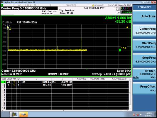

  • Update:
    Sporton has reported another failure to view a 40MHz channel bandwidth. Linux tools claim a 40MHz connection has been made, see below response from Sporton:
    The DFS test channel needs to be used in the UNII-2A (5250 ~ 5350 MHz) & UNII-2C (5470 ~ 5725 MHz) band and uses the maximum Bandwidth supported by the EUT. We still need to help deal with the problem of insufficient bandwidth. We need from the following red box within the channel test. (Usually we are using ch102_5510 MHz to do the test.
    This is just a matter of terminology...
    As you can see in the following table, we call ch102_40MHz  - ch100_lower or ch104_upper. Those two are actually the same - so you can use either one of them.
    Same goes for ch62_40MHz - we call it ch60_lower or ch64_upper
    So the channels are defiantly supported. Just need to define them correctly.
    Oren
    channel channel USA Europe Japan Global
    no. Lower Upper Lower Upper Lower Upper Lower Upper 40MHz channel
    5180 36 Y   Y   Y   Y   38
    5200 40   Y   Y   Y   Y
    5220 44 Y   Y   Y   Y   46
    5240 48   Y   Y   Y   Y
    5260 52 Y   Y   Y   Y   54
    5280 56   Y   Y   Y   Y
    5300 60 Y   Y   Y   Y   62
    5320 64   Y   Y   Y   Y
    5500 100 Y   Y   Y   Y   102
    5520 104   Y   Y   Y   Y
    5540 108 Y   Y   Y   Y   110
    5560 112   Y   Y   Y   Y
    5580 116 Y   Y   Y   Y   118
    5600 120   Y   Y   Y   Y
    5620 124 Y   Y   Y   Y   126
    5640 128   Y   Y   Y   Y
    5660 132 Y   Y   Y   Y   134
    5680 136   Y   Y   Y   Y
    5700 140
    5745 149 Y           Y   151
    5765 153   Y           Y
    5785 157 Y           Y   159
    5805 161   Y           Y
  • Thanks for the clarification. Sporton has succesfully tested 40 MHz ch bandwidth. They've notified us that they've passed both DFS NAT (Non-Associated Test?) & CMT (Channel Move Time?) but have failed Non-Occupancy Period. Suggestions on what could cause a failure of this type?
    Below are the traces. Same setup with different Access Points:
    cid:image002.png@01D30D4A.DDA97E50
    Can you please send us also an air sniffer log and firmware logs?
    This capture is not enough for our testing team to understand the issue.
    Eyal
