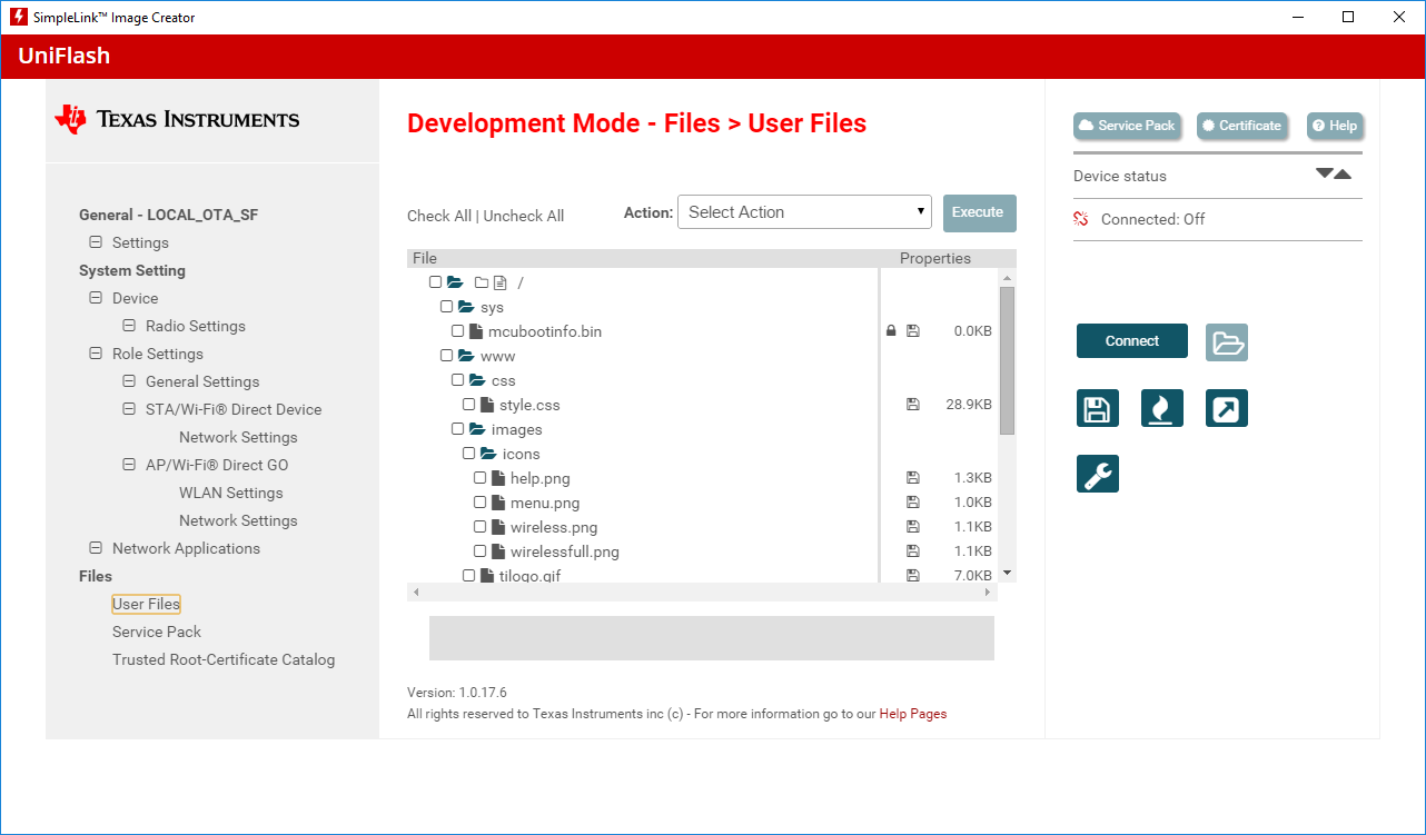

    Ok, so you meant "importing the project from the .zip file". This I managed to do now. Thanks!
    But when programming the image, nothing happens (no uart output, no wifi up).

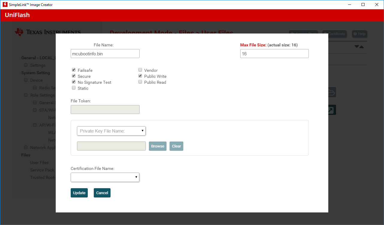

    I find it suspicious that the mcubootinfo.bin is 0.0KB. When downloading it, there is only one line in it (0000 0000 0000 0000 15db 42ae 00a0 2526).
    And apparently no certificates are used...
    I used the .zip project as it was.
    Did I miss something?

  • you may rebuild the project and get the bin file. Add the bin file to the sys/mcuflashing.bin.
  • Rebuild the project after you update the local access point configuration.

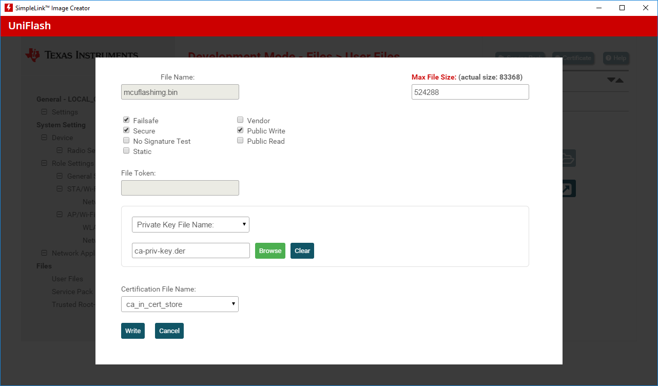

    - enter the certificates files (using the key that was in the .zip project (ca_priv_key.der) is that correct? )
    - Create & Program

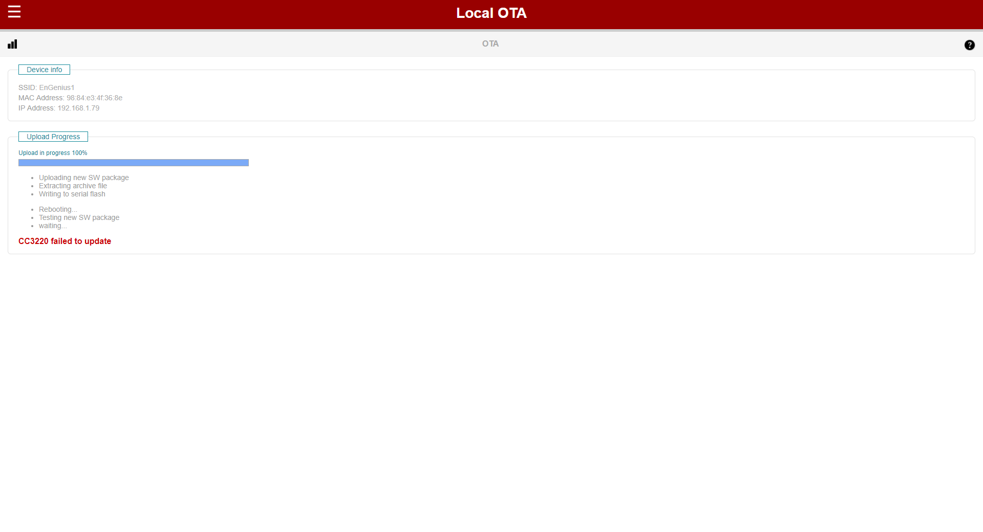

    - Create OTA
    - Open the web page and upload the *.tar file.
    - Update failed...

  • In fact, i also get updata fail from web page.  Maybe you can get some information from uart console.
    And you can check the readme.html :
    • Rarely, it is observed that the progress bar does not start or start but freeze in the middle; however the Over the Air update procedure is successful. In these cases, Board_LED2 (green LED, D5 on the board) indication and terminal printouts would show the true status of the procedure, and also the web client should eventually indicate a successful process.

  • Hi Vincent,
    Please use the latest SDK 1.40 (www.ti.com/.../simplelink-cc3220-sdk).
    At least the certificates in your image creator screenshot seem to be incorrect.
    Please use the new playground certificates from <sdk-root>/tools\cc32xx_tools\certificate-playground/.
    Note that you should program the entire certificate chain ((e.g. dummy-trusted-cert, dummy-trusted-ca-cert, and dummy-root-ca-cert). as user files before you set the image.
    Note also that the private key you provide should comply to the public one (e.g. dummy-trusted-cert-key & dummy-trusted-cert).
    br,
    Kobi
  • Thanks guys !
    I managed to get the update to work.
    The solution was to delete "ca-priv-key.der" from User Files.
    Note that using the playground certificates (as  suggested), instead of the ones pre-defined in the .zip Uniflash project, also works !
  • Other question:
    I noticed that some of the files present in User Files are not used (update still works if they are removed) :
    - "ota.dat"
    - "mcubootinfo.bin"
    Can you tell more about how to use and what are these files for?
