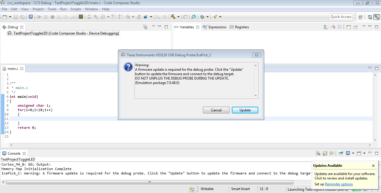

  • Hi Bryan, your instructions helped me to find out that my board and debugger do work properly.
    With Uniflash this all worked out perfectly fine, but I get problems doing so with CCS. When CCS tries to connect to the target during the debugging starting procedure, it says I should do an update (see the picture I added). When I start the update it says it is unable to connect to the target and I get error -265. What am I supposed to do now?

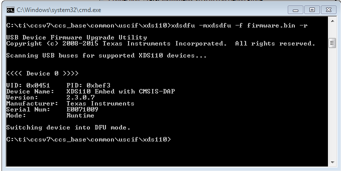

  • I also tried what it says in the error description. This is the output. Funny thing is, if i put this command in a second time, I get the message that the requested device was not found on the bus.

  • Sooo, I am happy and I could freak out at the same time!! We plugged in my board on the other computer. When requesting the debugger to start, the same message came up (make an update for debug probe). On this computer though, the update was made without a mistake and after the update was made the board now works on my computer, too!
    I spent many hours with this problem, but what I now learned is that you always buy 2 boards and install the SDK on 2 laptops.
    Thanks for your help, Sarah!
