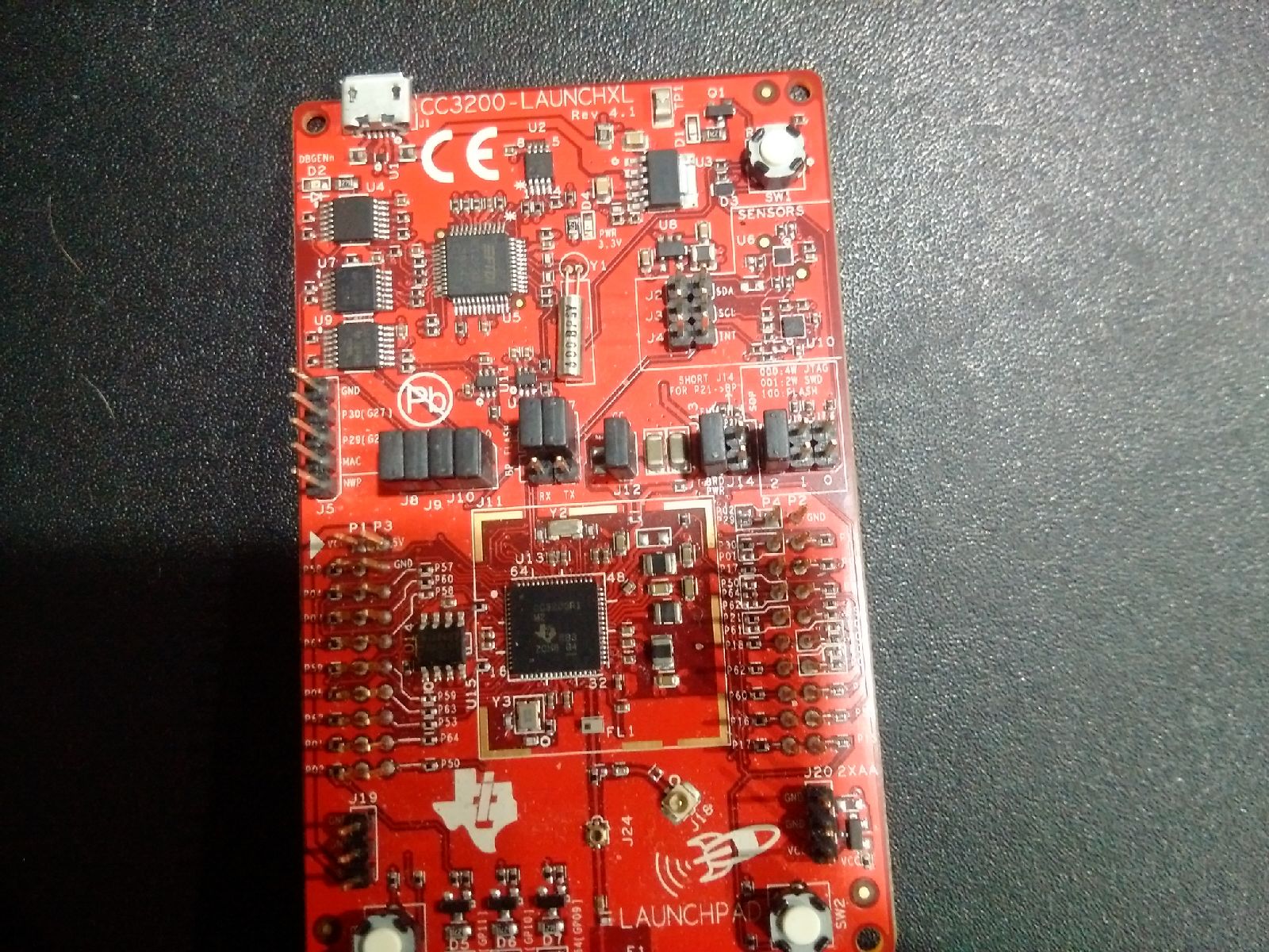

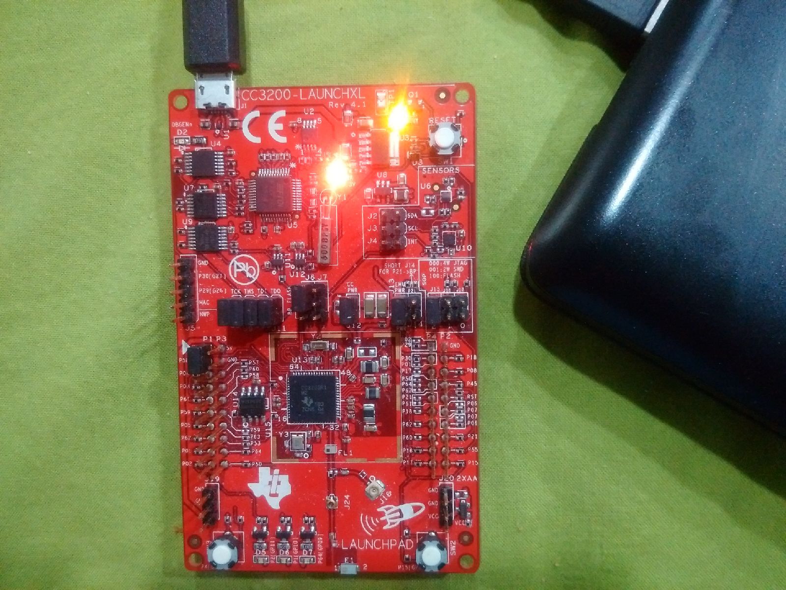

  • I added a jumper to the SOP pin 2   ( JP15).   However, that did not improve the situation.  I have a picture of my board.
    Please set jumpers on your CC3200 LaunchPad to default ( www.ti.com/.../getliterature.tsp ). For example you have disconnected TX line of UART (jumper J7) and from this reason cannot Uniflash work.

    I reviewed the manual for the cc3200 launch pad and set the jumpers so it programs the flash.    I also reviewed the Uniflash manual and confirmed the baud rate of the com port.   The manual only describes the baud rate and does not describe the rest of the com setting.
    This is still is not connecting.
    What is shown is Uniflash log? Please insert here log with enabled additional debug informations (Window -> Preferences -> UniFlash Preferences -> Print out additional debug information...).
