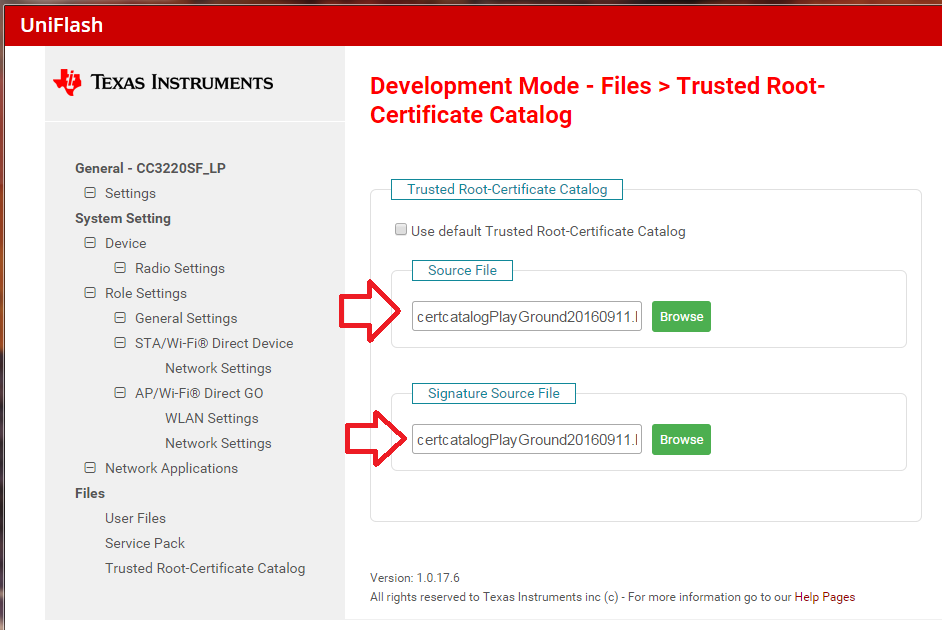

10 I then select Program Image. This appears to go well until the very end when I receive the following error message: Operation failed: fs_programming error: ret: -10287, ex_err: 2633 - FS_ERR_ROOT_CA_IS_UNKOWN

  • Hi Frank,
    Please check the "Trusted Root-Certificate Catalog" files and make sure that "Use default Trusted Root-Certificate Catalog" is unchecked. Then select the following files from the certificate-playground folder:
    * Source File: certcatalogPlayGround20160911.lst
    * Signature Source File: certcatalogPlayGround20160911.lst.signed.bin
    Screenshot -
    Ben M
  • Ben,
    Thank you.  That did the trick.  I had unchecked the box on some previous tries but didn't really know what to put there.  This has helped immensely.  Again, Thank you.
