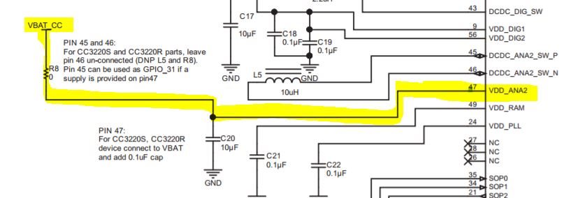

Dear all,
i am designing a board with the CC3220SF and can't find any detailed information what the DCDC_ANA2 is doing and when to use it.
As far as i understand it can be used to power flash and/or rtc. Is this related to internal or external components?
Is it required for the internal Flash of the CC3220SF ?
To what voltage will the DCDC_Ana2 regulate its output value on pin 47?
My application is not battery powered so i'd like to connect pin 47 VDD_ANA2 to my 3.3V power supply rail. Is this ok ?
Thanks for your support,
best regards,
KA
  • Hey Kjer,
    I'll do my best to answer your questions:
    This is for internal components of the CC3220
    Yes.
    Pin 47 should be connected to your VBAT_CC, which would be your 3V3 rail.
    http://www.ti.com/lit/ds/symlink/cc3220.pdf
    page 67.
    Pin 47 should be connected to your 3v3 rail and have a decoupling cap.
    Let me know if that helps, or if you have any more questions!
    Vince Rodriguez
  • Hi Vince,
    the schematic you posted only tells what to do with Pin 47 for CC3220S and CC3220R.
    In the CC3220SF_Sch.pdf provided with the CC3220-LAUNCHXL design files Pin 47 is NOT connected to VBAT.
    There is 10uH between pin 45 and pin 46. Pin 47 in connected to 10uF.
    I guess this is related to the internal Flash that is only available with the CC3220SF.
    I guess that this internal Flash needs a pre-regulated power supply different to VBAT (3.3V).
    Could you please check if it is allowed to connect 3.3V to pin 47 of the CC3220SF?
    Or is this only related to a power saving state, that power to Pin 47 (internal Flash supply) can be shut down?Best regards,
    KA
  • Kjer,
    The schematic i shared is what you should do when using the CC3220SF. The footnotes/descriptions tell you what you need to do if you are using the S or R device.
    Please tie pin 47 to VCC and use the decoupling cap.
