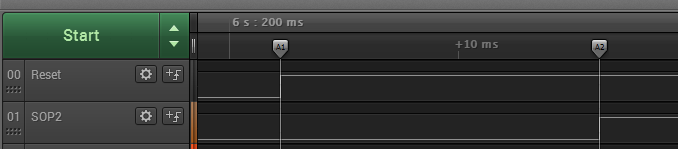

  • Ok, I made the mods per all the previous posts.  And with thru the design checkoff list again.  I'm still having problems.  There is some activity on the TX line and nothing on the RX.  The TX line is loaded down to 2.74V for a bit then pops up to 3.3V and then there is a transmission.  The RX is loaded with 1.74V and does nothing.  I've been playing around with this for 2 days. Is there a local FAE that can help me?
  • I just completed another test. I took a module by itself and wired GND (all locations) , VBATT (both locations) , RESET, RX, TX to LanchPad board emulator section. It has the same problem as the custom board I made with the UniFlash program. There must be something we are missing. Any Ideas? Does the module need to be programmed with something first or does it boot up looking at the RX, TX lines? If I connect the LaunchPad board up using the other section (CC3220MODSF module ) it works fine and the RX, TX signals look great.
  • Dave,
    1) Have you tried replacing the module with a new one after replacing the 0ohm resistor on SOP1 with a 270 ohm?
    2) When you try to flash the module with Uniflash, what do you see on the reset and SOP2? The module should reset and the SOP2 should go high after roughly 14ms. This makes the device boot into UART programming mode. Below is an example of what you should see.
    3) Another test you can try is to put the device in JTAG mode and use CCS to run an SDK example that uses a terminal emulation program such as Tera Term. This way, you can verify whether or not your UART pins are working.

  • Per my last post. I tried a module by itself with the same results. To replace a module with a new one, I'd need to send it back to the CM to have it replaced. That could take 1-2 weeks. Also, I want to make sure that the module is bad before doing that. I'm not so sure it is bad if the test I did with module by itself does the same thing. I'll look at the timing in the morning and will let you know.
  • Dave,
    Ensure that you are also pulling up SOP1 with 270ohms when you test the module by itself tomorrow.

  • I got working!  I wanted to mention a couple things.
    1.  For the reset to work properly I needed to have the BRD and BRD/VBuffer jumpers loaded on the CC3220 LaunchPad board.  The VCC_Buffer provides the Bus Transceiver IC with side A voltage, which provides the nice reset signal needed when using UniFlash program.
