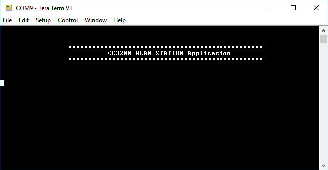

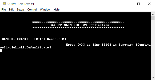

I cannot get this program to run off the the launchpad. I followed the Getting Started Guide for the launchpad, and CCS says the program was flashed correctly, but the device will not connect to my router and there is nothing coming out of Tera term. I also programmed the board with the provisioning_wps.bin file in the SDK with CCS UniFlash, but that did not work either. To troubleshoot, I programmed the device with blinky.bin (also found in the SDK) via UniFlash and it is working properly.
I am currently using CCS 6.2.0 for  this project, and I do not see how using 7.3 would make any difference.
What could I be doing wrong? Is there somewhere I can troubleshoot this with Tera term not working?
