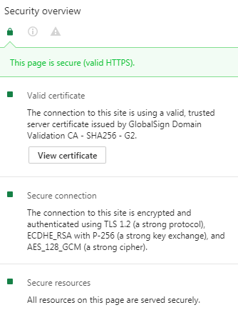

My customer is using CC3200MOD and wants to connect it to https server.
Security specification at server side:
- Protocol : TLS1.0
- Certification parameter : Key RSA 2048bits, Hash algorithm SHA-256
- DV certification is used
- See attached sec.png which is taken by PC browser when the browser is connected to the server.

  • Hi KoT
    If you simply don't set the secure mask and method then the CC3200 can fully negotiate with the server which one is best.
    -Aaron

  • I believe that should work. The HTTP client library will not set the method and mask if they are set to 0.
    -Aaron
