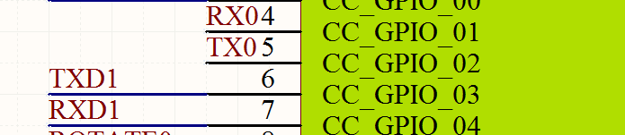

pin initial effect the UART0 print.
it is the inresting issue .when i initial the pin ,it will affect the print of uart0. or the UART0 print function just stop.
but i see the real pin connect to the uart0 is PIN_55,PIN_57.
why i config orther pin will effect thoes two pins.

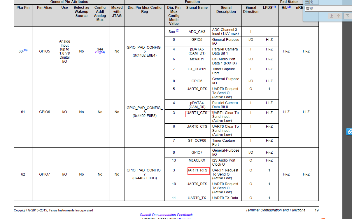

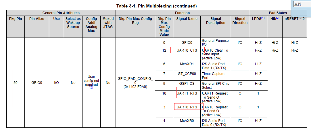

i saw the PDF,and find some relation to the UART0
here is my way i init .

// MAP_PinTypeGPIO(PIN_50, PIN_MODE_0, false);
// MAP_GPIODirModeSet(GPIOA0_BASE, 0x00, GPIO_DIR_MODE_OUT);
How can I avoid that?  or change some opinion.
