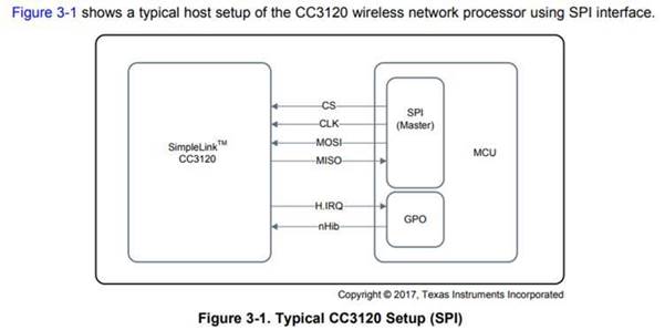

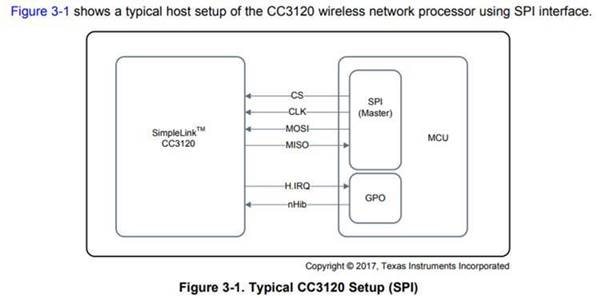

Kindly advice if we may have connected the CC3120 Network processor incorrectly for use with TI Uniflash program.
Can you please advise on this topic as we have the following documentation from the development documentation?

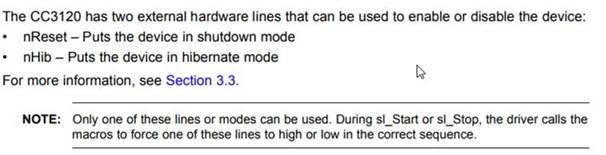

Either nHib, or nReset is required for control of the CC3120, not both.
We understand that the TI Uniflash program does not work without nReset exposed, but this is not a design flaw, but a tool flaw from TI as the previous versions of UniFlash for CC3100 did not require the nReset, only nHib.
Our production programmer was originally developed for CC3100 and is still being used for CC3120 now. Please advise.
Thank you.

  • Ken -
    Uniflash toggles both lines - nRESET and nHIB to enter programming - can you share a logic capture and schematic of the application, so we can see what the actual problem is? Programming the serial flash and use of the device for its intended application are two separate use cases.
    thanks!
    to make it clear - here is a logic capture of UniFlash v4.2 programming the service pack onto CC3120BOOST, using CC31XXEMUBOOST
    as you can clearly see, both nHIB and nRESET lines are toggled before and after programming.
