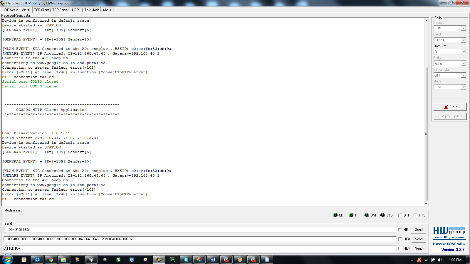

Hi
We are struggling to connect to one of our customer HTTPS server using CC3200 Launchpad through WiFi. Their server uses "Go Daddy Secure Certificate Authority - G2"  CA certificate TLS 1.2 method and TLS_ECDHE_RSA_WITH_AES_128_GCM_SHA256 Cipher suit. We tried using all the available Cipher suits combinations in CC3200 but connection failed.
Then for to test https we tried connect to google using Equifax CA certificate and SL_SEC_MASK_TLS_RSA_WITH_AES_256_CBC_SHA cipher suit, connection is successful. But when i tried to use Google Internet Authority G2 CA certificate, connection failed.I think that also require TLS_ECDHE_ECDSA_WITH_AES_128_GCM_SHA256 Cipher suit which is not available in CC3200.
Is there any option to select cipher suit automatically?
What are the possible to solutions to solve this issue from CC3200 side? Changing server configuration is not at all possible every time. or do we have to move to other solutions.  Please reply.
Honey
  • Hi Honey,
    Please try to use SL_SEC_MASK_SECURE_DEFAULT and let the server decide what mask to use.
    Jan
    Thanks for the quick reply.
    I tried SL_SEC_MASK_SECURE_DEFAULT but connection failed. I selected SL_SEC_MASK_SECURE_DEFAULT with google Equifax CA certificate then that condition also failed but before i got successfull connection with SL_SEC_MASK_TLS_RSA_WITH_AES_256_CBC_SHA. I tried Google Internet Authority G2 CA certificate and GeoTrustGlobalCA with SL_SEC_MASK_SECURE_DEFAULT but no way of getting connection.
    See the screenshot of failed conditions.
    Honey

    also see the code snippet and screenshot of certificates used.

  • Hello Honey,
    I think there a couple of issues here.
    In your original post :-
    This cipher suite (using the Galios/Counter Mode) is *not* supported on Gen1 (CC3100/CC3200).  This suite was added as part of the updated features supported on Gen2 (CC3120/CC3220).  There should however be other TLS 1.2 ciphers supported by your server, so I would expect you to be able to connect with other ciphers.  Have you tried connecting with the other cipher suites?
    FYI, here are the ciphers suites supported by the different SimpleLink Wi-Fi devices at this time :-
    CC3100 / CC3200 / CC3120 / CC3220
    TLS_RSA_WITH_RC4_128_MD5
    TLS_RSA_WITH_RC4_128_SHA
    TLS_DHE_RSA_WITH_AES_256_CBC_SHA
    TLS_ECDHE_RSA_WITH_AES_256_CBC_SHA
    TLS_ECDHE_RSA_WITH_RC4_128_SHA
    TLS_RSA_WITH_AES_128_CBC_SHA256
    TLS_RSA_WITH_AES_256_CBC_SHA256
    TLS_ECDHE_RSA_WITH_AES_128_CBC_SHA256
    TLS_ECDHE_ECDSA_WITH_AES_128_CBC_SHA256
    CC3120 / CC3220
    TLS_ECDHE_ECDSA_WITH_AES_256_CBC_SHA
    TLS_RSA_WITH_AES_128_GCM_SHA256
    TLS_RSA_WITH_AES_256_GCM_SHA384
    TLS_DHE_RSA_WITH_AES_128_GCM_SHA256
    TLS_DHE_RSA_WITH_AES_256_GCM_SHA384
    TLS_ECDHE_RSA_WITH_AES_256_GCM_SHA384
    TLS_ECDHE_ECDSA_WITH_AES_256_GCM_SHA384
    This is an issue with the TLS handshake with some servers on CC3100/CC3200.  When using 'SL_SEC_MASK_SECURE_DEFAULT', the CC3200 will share all the cipher suites that it supports and the server will pick the best one.  In the case of google.co.in, the 'best' mutually supported suite is TLS_ECDHE_RSA_WITH_AES_256_CBC_SHA, *however* CC3200 doesn't currently support the elliptic curve handshake that is also required (by this server (and maybe your server?)) to use this mode - hence the failure here.  This specific handshake is already supported on CC3120/CC3220 and is possible to add to the CC3100/CC3200, so we will be add this in an upcoming service pack for CC3100/CC3200 in the coming months.
    In the mean-time, if you are using the DEFAULT mask to connect to your server, then I would suggest trying each supported cipher individually to verify those that are successful.  You can then either pick the best one, or create and use a mask that contains the compatible ones for your server.  It would be interesting to know your results.
    Hope that helps,
    ~roger

  • Hi Honey,
    The MASK is just a bit mask of the suites, where the DEFAULT mask contains all.  For example, you could use something like :-
    // create mask with desired ciphers
    #define MY_MASK ( TLS_RSA_WITH_AES_256_CBC_SHA | TLS_DHE_RSA_WITH_AES_256_CBC_SHA )
    or
    // remove cipher from default set
    #define MY_MASK ( SL_SEC_MASK_SECURE_DEFAULT & ~SL_SEC_MASK_TLS_ECDHE_RSA_WITH_AES_256_CBC_SHA )
    Cheers,
    ~roger
  • Hi roger,
    I tried couple of attempts with all masks and combination of masks but unfortunately it can not succeed. Do you have any timeline for the release of new service pack with elliptic curve handshake feature?. For demonstration purpose we have to use our current setup with CC3200 and future we can switch to CC3220.
    So is there any option to use TLS/SSL layer in application controller with new security features without touching the old TLS/SSL layer in network processor? I read about this concept but hard to understand the implementation level. Do you have any specific guide to implement this concept quickly for our demonstration purpose? or is it possible?
    Honey
  • Hi Honey,
    You will just have to get dodaddy to change the encryption method for you, or change to a different server until you move to CC3220.
    -Aaron
