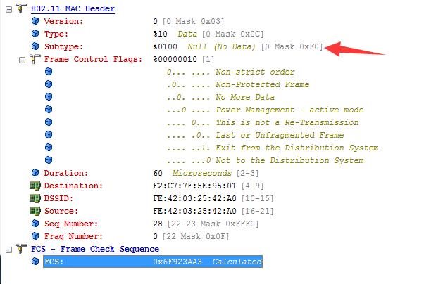

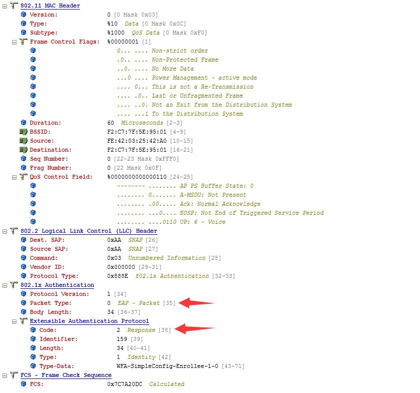

Linux/WL1835MOD: P2P wifidisplay connect compatible issue
Part Number: WL1835MOD
Tool/software: Linux
wl18xx as P2P GO role that set go_intent=15 some cell phones can't connect to(known: samsung_c9_pro/gionee/vivo_x9/vivo_x9_plus), but change wl18xx to P2P GC role that set go_intent=0 is OK, following is part of wl18xx driver debug and wpa_suppliant debug log:

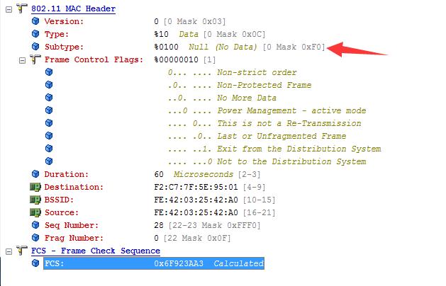

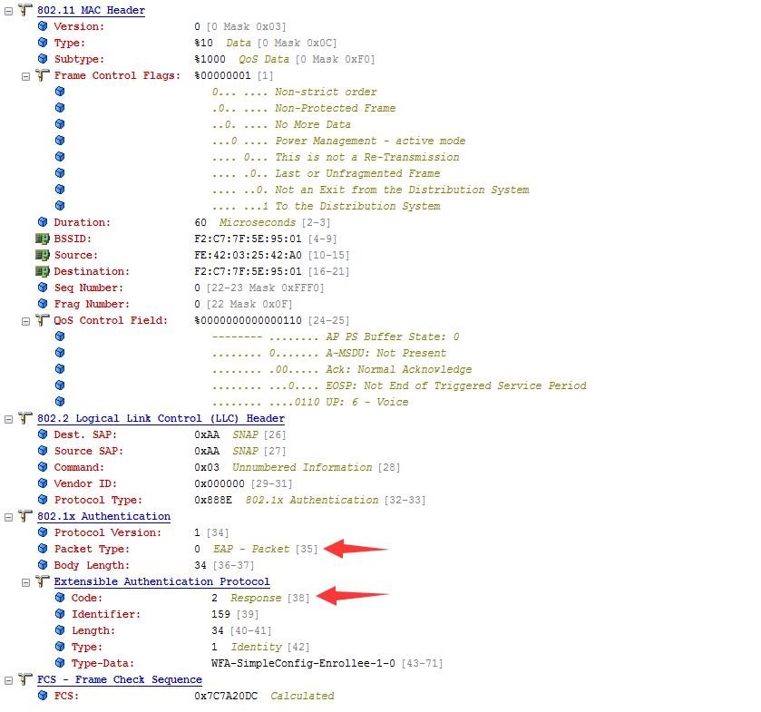

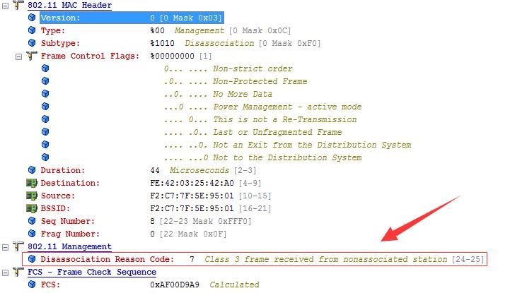

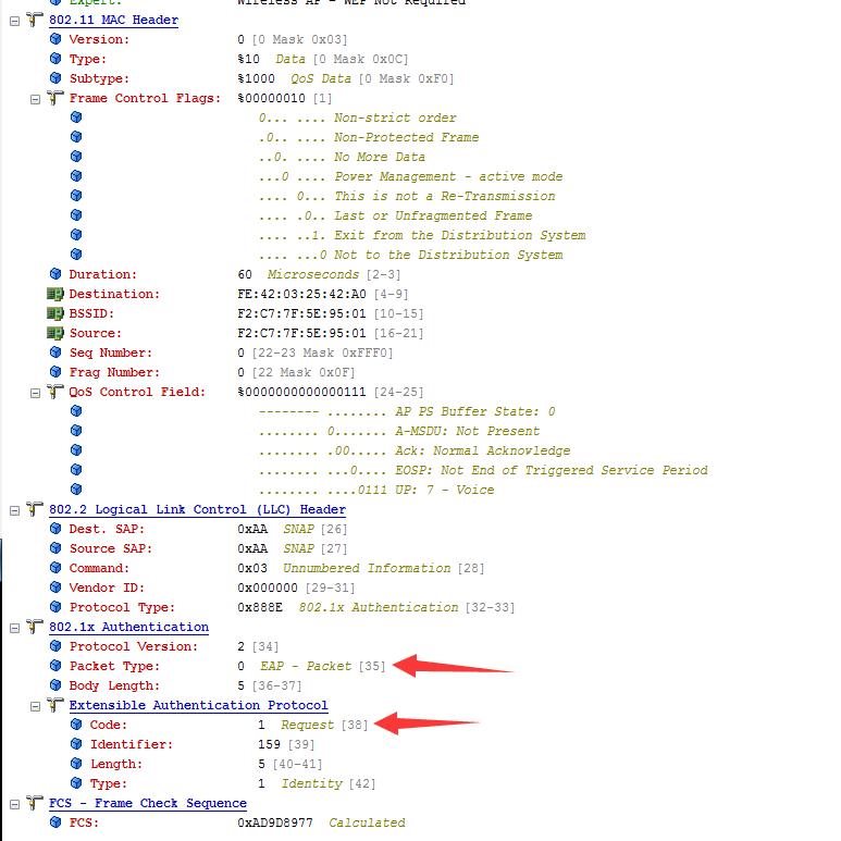

    I think i had found where the problem is, when wl18xx as GO role some cell phones can't connect to(known: samsung_c9_pro/gionee/vivo_x9/vivo_x9_plus)
    I had captured the air log by OmniPeek sniffer software,  the following steps may be where the problem is:
    prerequisites: the "Provisioning" phase begins after  finish GO Negotiation
    1. wl18xx GO side send EAP Request packet to phone GC side
    2. phone GC side send a null data class 3 frame to wl18xx GO side
    3. follow on the phone GC side send the EAP response packet to wl18xx GO side
    4. wl18xx GO side received the NO 2 packet (null data class 3 frame) at first, and do disassociate
    Is my analysis correct? How can I solve this problem? attachment is the air capture log, please refer to, thank you!
    samsung_c9_pro.zip
  • Hello Clark Zheng,
    Going over the information you've sent it seems we've behaving as expected.
    When we are not connected yet the client is supposed to send us the EAP response.
    it's not allowed according to the SPEC to send us any other packet.
    in this case the phone sends a NULL packet. we are still not connected at this stage.
    which causes us to disconnect - which is according to the spec.
    this phone doesn't behave according to the WiFi spec,
    BR,
    Chen Loewy
