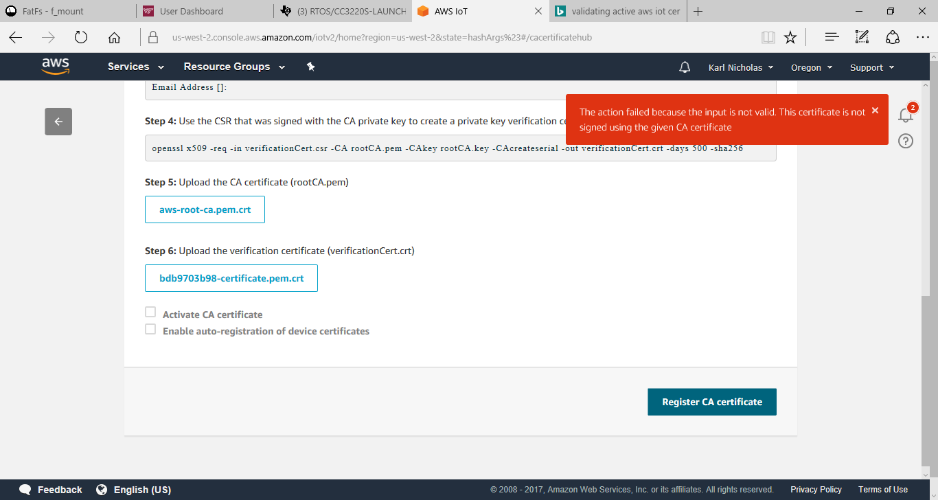

  • I don't know if it should work, but AWS won't allow you to register the certificate they generated.
  • I also found this thread -- my "region" is us-west-2 since my endpoint

    Regards the certificate registration in AWS. this is for another purpose. You can register your own root ca certificate there and configure AWS such way that it will accept all client certificates generated by you using this root CA.

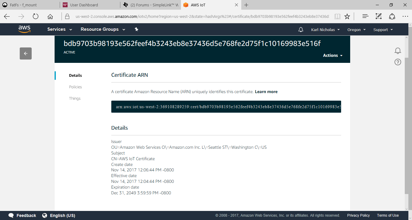

    The thing is the AWS-IoT certificate that is issued for use with MQTT doesn't seem to have any valid issuing path, so I'm pretty sure having the AWS root certificate around is meaningless since the AWS-IoT certificate can't chain to it anyway.
    The simplelink socket code may work with a valid certificate chain but the certificates being issued by AWS-IOT aren't certified. So I think it's a lost cause in the case that people are trying to use those certificates in this sample code. If the sample code is assuming the certificates are certified then it will always fail with the aforementioned error.
    $ openssl verify af02dc3615-certificate.pem.crt
    af02dc3615-certificate.pem.crt: C = US, ST = CA, L = San Francisco, O = Karl Nicholas, OU = Self, CN = 6abf887188407c736bad2a563d8d03cebe5bd0d1c64ae3f97e56b89e23988588, emailAddress = XXX
    error 20 at 0 depth lookup:unable to get local issuer certificate

    You can see earlier in this thread that I'm getting the certificates from the AWS IoT console, client and private key generated, root ca just downloaded.
    Is your MQTT endpoint in US-EAST or US-WEST? Mine's on US-WEST-2. I saw on some github threads some conversation about this and AWS seemed to say it made a difference.
    Otherwise, I'd be happy to try to connect to an endpoint and certificate that you have that works, or visa versa if you want. I can send you my certificate and a screen-shot showing it's activated. Don't use the ones posted earlier in this thread because I have revoked them, but it's easy enough to create new ones or send you the one I'm trying at the moment.
    I'm really not doing anything fancy that I can tell.

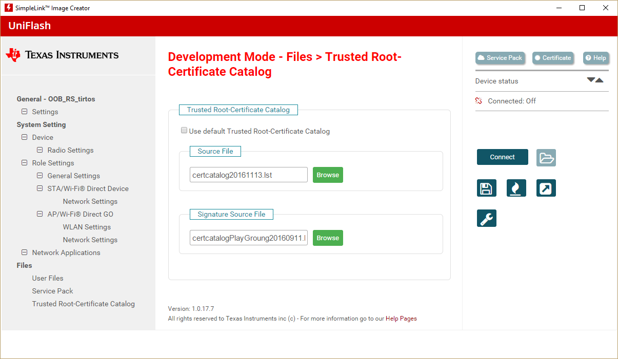

    I think I misspoke when I said I thought that the root ca list in the CS3220 had been update with a valid file from the certificate-catalog folder.
    In fact I have been using the certificate-playground stuff, which is all "dummy" certificates.
    I tried flashing an OOB build with the certificate-catalog folder but I am not able to make it work, which is not particular surprising since I have not read any documentation on this yet. I got a "root ca unknown" error, or perhaps a "file not found" error depending on what I tried.
    My intention is to flash the a OOB binary with valid certificates from certificate-catalog and then have the aws shadow run okay without a SL_ERROR_BSD_ESECUNKNOWNROOTCA when I debug it from CCS-7.
    Does this even make sense?
    It is possible I need to have my own certificate in order to flash an OOB binary with the valid certificate-catalog certificates? If so, would a "code signing" certificate work, or a "self signed" certificate?
    Thanks.

    I don't think so. What I did was flash the OOB (Out of Box) application to the CC3220 and then run the Shadow example from CCS.
    When I flash the OOB application I can only successfully do so using the certificate-playground certificates. I have not been able to flash using default Trusted Root-Certificate Catalog (If I remember correctly I get a FS_FILE_NOT_FOUND ) or adding the certificates from the certificate-catalog (If I remember correctly I get a FS_ROOT_CA_UNKNOWN).
    So, my current supposition is that I need to flash an application, I presume any application, signed with a certificate that I purchased somewhere. My current supposition is then I will be able to use the proper certificates from the certificate-catalog.
    I'm thinking once those certificates from certificate-catalog are flashed in the CC3220 then the Shadow example will authenticate properly however I run it, either by flashing it or by running in debug mode from CCS.

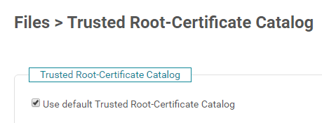

  • Hi Karl,
    Can you please try the following steps and let me know if they allow you to run the Shadow Example from CCS?
    1. Using Uniflash, configure the default cert store:  .
    Disconnect from Uniflash. Please make sure that your board is disconnected from CCS and powered down.

    I used UniFlash and set the Use Default Trusted Root-Certificate Catalog as you mentioned.
    However, I'm still getting the same result. The Shadow example runs but gives me the SL_ERROR_BSD_ESECUNKNOWNROOTCA error.
    The thing is when I connect to the CC3220 with UniFlash and look at the files on the system there are no files "/files/certstore.lst" or "/files/certstore.lst.signed". Where would they come from?
    I tried copying "certcatalog20161113.lst" to "certstore.lst" (and the signed file) and writing those files to the above mentioned locations, but it did not help. I still get the same SL...UNKNOWNROOTCA.error.
    Where should I get able to get these /files/certstore.lst files? Are they in the SDK or somewhere online?
