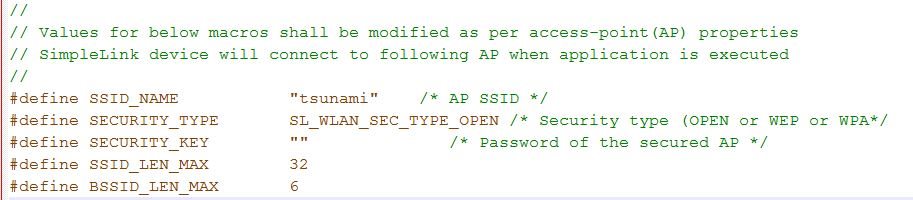

   i am using ccs 7 version ,wlan ap sample code in ccs edited to wlan ap mode with password authentication .but i am getting only open wifi ,no authentication/passsword .here i am added below my code .
 Did anyone tried this code with password. i am waiting for reponse.
