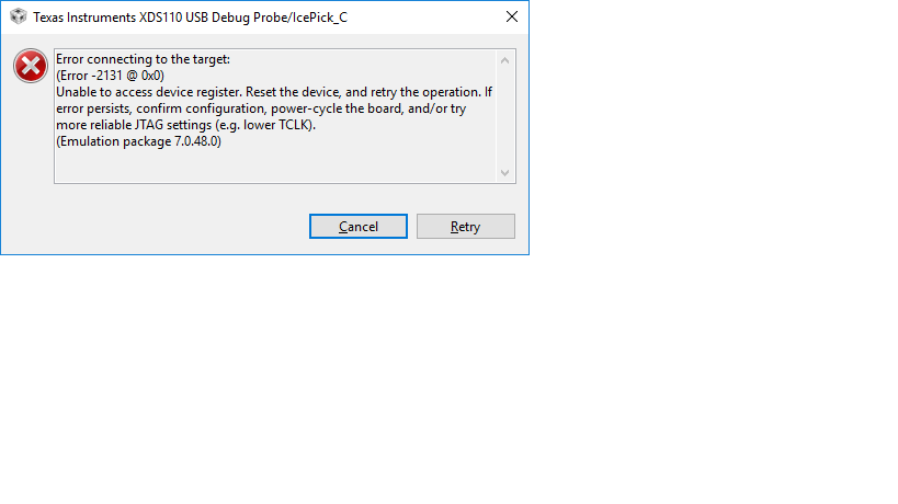

 Out of the blue, after making routine code changes, I started getting the dreaded "Error -2131" popup as per the attached screenshot.
Cycling power (by unplugging the USB cable to the LP board) and even the whole PC does not clear the problem.
I also tried a second second LP board with its own USB cable and a different USB port on the PC.
My code uses the "__SF_DEBUG__"  technique, but I've been using that for months. It does, however, appear (based on LED activity) that the latest code changes have made it to the internal flash (unplugging/reconnecting the USB cable shows it running).
I went back to TI's gpiointerrupt_CC3220SF_LAUNCHXL_nortos_ccs project and now get "Error -2131" there.

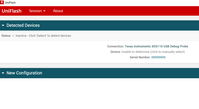

Is there something my code could have somehow done on the board to make it "deaf" to CCS' efforts to connect to it? If so, how do I "clear" things? I also fired up UniFlash only to find that it does not appear to be able to identify the board!

  • OK, I figured out a way to un-"brick" my CC3220SF Launchpad boards:
    Using UniFlash (4.2.1.1562):
    New Configuration (CC32230 LP/Serial)
    Start Image Creator
    Manage Projects / Recent Projects / OOB_SF_freertos
    Connect
    Program Image (Create & Program)
    USB cable -- DISCONNECT and RECONNECT --- this is essential
    CCS (7.3.0.00019 ):
    Select my (__SF_DEBUG__-enabled) project
    Debug (which I have configured to do a Target Reset which is reflected in CCS "Console" window)
    Start TeraTerm
    Resume (green triangle)
    Interestingly, the first call to MAP_PRCMSysResetCauseGet returns 0x00000007 (PRCM_HIB_EXIT) [with PRCMHibernateWakeupCauserGet returning 0x00000002(PRCM_HIB_WAKEUP_CAUSE_SLOW_CLOCK], instead of 0x00000002 (PRCM_POWER_ON) which I expected. I will ask about this in a new thread.
