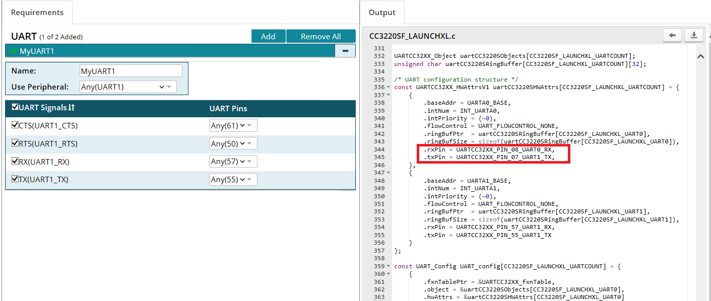

My customer reported a strange behavior in PinMux Tool (cloud version 4.0.1510).
Target device is CC3220SF (Default package).
When they simply added UART1 to the system, the tool automatically added UART0 with incorrect pin assignments.
Please see below snapshot.
Below two pins are assigned to UART0, but there is no UART0_RX function for PIN_08.
And there is no reason UART1_TX is assigned to UART0.
       .rxPin = UARTCC32XX_PIN_08_UART0_RX,
       .txPin = UARTCC32XX_PIN_07_UART1_TX,
If customer uses this output file (CC3220SF_LAUNCHXL.c), build fails with errors of course.

    When I do the same and use the same cloud version, picking UART1 only as you did, I get:
    const UARTCC32XXDMA_HWAttrsV1 uartCC3220SDmaHWAttrs[CC3220SF_LAUNCHXL_UARTCOUNT] = {
            .baseAddr = UARTA0_BASE,
            .intNum = INT_UARTA0,
            .intPriority = (~0),
            .rxChannelIndex = UDMA_CH8_UARTA0_RX,
            .txChannelIndex = UDMA_CH9_UARTA0_TX,
            .rxPin = UARTCC32XXDMA_PIN_08_UART1_RX,
            .txPin = UARTCC32XXDMA_PIN_07_UART1_TX
            .baseAddr = UARTA1_BASE,
            .intNum = INT_UARTA1,
            .rxChannelIndex = UDMA_CH10_UARTA1_RX,
            .txChannelIndex = UDMA_CH11_UARTA1_TX,
            .rxPin = UARTCC32XXDMA_PIN_57_UART1_RX,
            .txPin = UARTCC32XXDMA_PIN_55_UART1_TX
    If I pick UART0 as pins 55/57 and UART0 as pins 07/08, I get:
    /* UART configuration structure */
            .rxPin = UARTCC32XXDMA_PIN_57_UART0_RX,
            .txPin = UARTCC32XXDMA_PIN_55_UART0_TX
    So i do not see what you are seeing, which is strange.

  • Hi Shlomi,
    The differences are what you are seeing is;
    I am checking;
    UARTCC32XX_HWAttrsV1
    Anyway, the tool generates wrong pins for both cases.
    In your code, below Pins are assigned for UART0, but they are UART1 pins.
    Thanks and regards,
    KoT
    I had a typo when writing: "If I pick UART0 as pins 55/57 and UART0 as pins 07/08".
    The 2nd one should be UART1 which is aligned with what you see.
