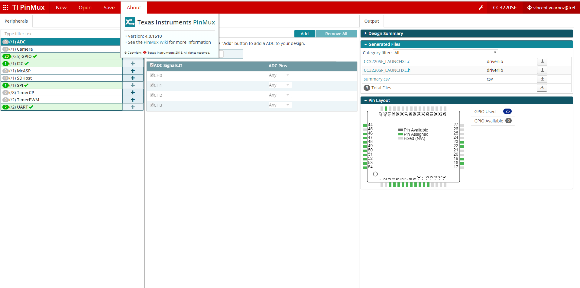

PINMUXTOOL: CC3220SF_LAUNCHXL.h does not update
Part Number: PINMUXTOOL
Hi community !
I have set up all my GPIOs in the PinMux tool (see pinmux file attached). But the CC3220SF_LAUNCHXL.h file doesn't seem to update. The "typedef enum CC3220SF_LAUNCHXL_GPIOName" still only contains the GPIO for the LAUNCHXL eval board (see below).
Am I missing something ?
 *  @def    CC3220SF_LAUNCHXL_GPIOName
 *  @brief  Enum of GPIO names on the CC3220SF_LAUNCHXL dev board
typedef enum CC3220SF_LAUNCHXL_GPIOName {
    CC3220SF_LAUNCHXL_GPIO_SW2 = 0,
    CC3220SF_LAUNCHXL_GPIO_SW3,
    CC3220SF_LAUNCHXL_GPIO_LED_D7,
     *  CC3220SF_LAUNCHXL_GPIO_LED_D5 and CC3220SF_LAUNCHXL_GPIO_LED_D6 are shared with the
     *  I2C and PWM peripherals. In order for those examples to work, these
     *  LEDs are  taken out of gpioPinCOnfig[]
    //CC3220SF_LAUNCHXL_GPIO_LED_D6,
    //CC3220SF_LAUNCHXL_GPIO_LED_D5,
    CC3220SF_LAUNCHXL_GPIOCOUNT
} CC3220SF_LAUNCHXL_GPIOName;
6332.CC3220SF.pinmux.zip
    Can you make sure that the corresponding CC3220SF_LAUNCHXL.c file is updated correctly?
    Not that i do not say it is a bug but I do not see the CC3220SF_LAUNCHXL_GPIOName enum being used anywhere in the code.
    Shlomi
  • Hey Shlomi ! Thanks for your reply.
    Yes, it is. I have attached both files for your reference.

  • Online. (https://dev.ti.com/pinmux/app.html)
    v4.0.1510
  • Can you please use the Desktop version?
    I have sen some issues with the cloud version.
    Shlomi
  • Same issue with the desktop version...

  • One more question:
    The "CC3220SF_LAUNCHXL.c" file generated by the PinMux tool doesn't seem to have any Timer_config objects (compared to the "CC3220SF_LAUNCHXL.c" file that is present in the SDK's examples).
    How to access the micro-processor's internal timers from the application ?
    Do you use it for internal usage of counting/measuring time or need to use the device pins as well (e.g. PWM, CCP)?
    You are right that it is not generated, and again I would add it to the bug report, but you can add it manually for now.
    Shlomi
