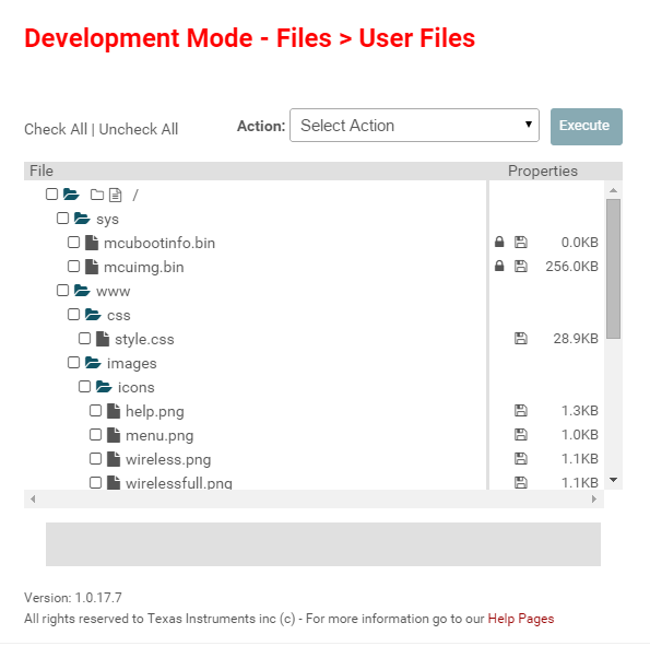

I started a thread about this and have done everything asked by TI, but it now appears no one answering anymore.  Basically the DHCP stops assigning IP addresses and the only way to get it to start again is to power cycle which really isn't even a fix.  I've updated to the 1.50 SDK and I captured a NWP log of the issue (log file can be found at the link below).  This happens randomly on connects, but for me to get it to happen consistently I have to perform multiple connect/disconnects each followed by a webpage refresh.  This happens on custom and Launch-XL hardware.  Can someone at TI please pass this on to the appropriate people to get this resolved.  This is a major reliability issue for our application.
http://e2e.ti.com/support/wireless_connectivity/simplelink_wifi_cc31xx_cc32xx/f/968/p/631816/2364058#2364058
  • Hello Andrew,
    Also posted the other thread but since you started a new one, we better continue with this one.
    The sniffer capture as you say is only after the problem occurs.
    Might be useful to capture some time earlier but I have also looked at the NWP logger  and I do see getting the DHCP DISCOVER and sending back DHCP OFFER (which doesn't get response).
    Can you elaborate regarding what you do on the client side when IP is released? Are you originating it from the client (this is what I see at least)?
    Lastly, you are using servicepack 3.3.0.0 and there is a newer 3.5.0.0 with some fixes. Can you try it out just to align on the latest? it does not involve any porting/migrating of any kind. This is the NWP set of patches.
    Shlomi
    I’m not sure what you mean by service pack 3.5.0.0?  I was told to get SDK 1.5.x.x.  Can you elaborate more on this?
    I’m using the http server.  All I do is connect to the simplelink AP on an iPhone.  I then do a page refresh in the safari browser for 10.123.45.1.  If it gets an IP and webpage loads, I then disconnect by connecting to different WiFi AP using iPhone WiFi control panel.   I then repeat and then repeat again until failure.  When I do this sometimes it connects and the phone gets an IP from the simplelink dhcp and other times it doesn’t and the iPhone resorts to link local addressing which isn’t good.  There is a wire shark capture in the previous post as well.  It appears the dhcp locks up because there is no dhcp traffic on the network.  I do this technique to increase the frequency of failure.  Otherwise it just randomly happens when I decide to connect to simplelink AP.
    My NWP log was running before the dhcp lockup occurred.  I powered the board up and then started the log.  There should be at least two successful connect and disconnect events before the failure.
    Each SDK contains the latest servicepack which is the set of patches applied to the internal network processor. You can refer to it as a new firmware update.
    You can find it under <SDK install dir>/tools/cc32xx_tools/servicepack-cc3x20/sp_3.5.0.0_2.0.0.0_2.2.0.5.bin.
    You should use Uniflash and add it to your project. Then, reprogram the device.
    I do see some connect-disconnect at the beginning of the file where the disconnects originated from the client. This is why I was curious to verify that you disconnected from your side (which explains it).
    Can you check with the new servicepack?
    Also to make sure, what happens if you use another client at this point? are you still unable to get an IP address?
    Shlomi
  • I will try that the new SP. Yes, once the lockup happens other clients won’t get an IP
  • Hi Shlomi,
    Where do I add the file under "user files" and what do I need to name it?   I don't even see that file list in "user files" when I pull up the out_of_box_demo in uniflash from the 1.50.x.x SDK.
  • Hi Shlomi,
    I updated the service pack using Uniflash to the 3.5.0.0_1.0.0.0_2.2.0.5  I captured a new NWP log.  You should see several successful connections at the beginning.  The 2nd to last is where the DHCP stopped giving out IPs.  I then disconnect and try to connect again and still failed to obtain an IP address.  Let me know what you think.
