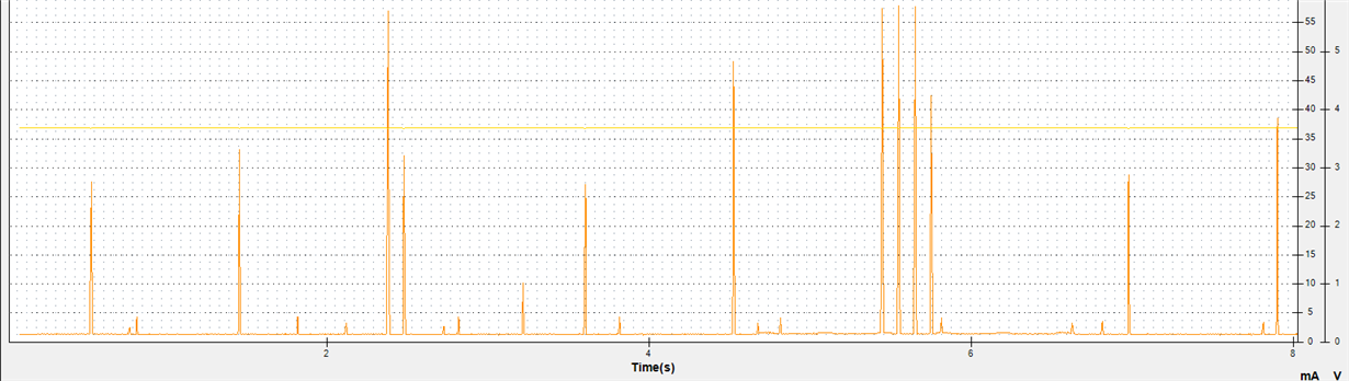

Our CC3220 is set to use LSI PM policy for the NWP with a max sleep interval of 1 second.
When it is working properly, the power consumption looks something like the following image:

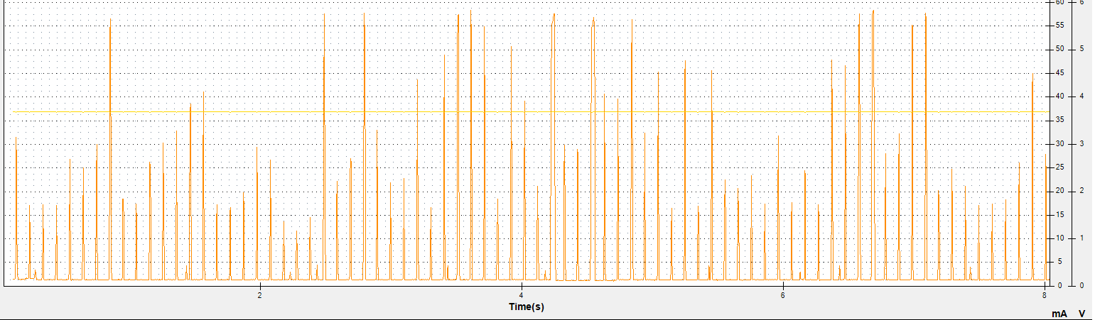

However, I have noticed that even though this policy is set, *sometimes* the NWP is waking up much more frequently, as in the following image:
Typically this happens after we change roles from STA to AP and back to STA, however, all the policies are being properly re-set after switching, and we restart the NWP...
Can anyone comment on how to debug this?
