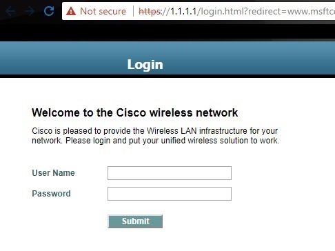

Connecting issue to an open Wi-Fi with a web login without any certificate
One of our client has to connect to an open Wi-Fi with a web login without any certificate as shown in the picture attached below.
I tried to configure Enterprise connection but it doesn't work and i'm not sure if it is needed in this case.
I searched the forum for solution but couldn't find anything on this kind of connecting that doesn't have any certificate.
Only SSID, user name and password are required.
If i'm not mistaken this type of connection is called captive portal.
Please advise,
  • Hi Michael,
    Captive portal is not supported by CC31xx/CC32xx devices. Captive portals are designed for interaction human person and not for machine. From this reason is almost not possible create universal solution for connecting captive portal without human interaction.
    You need to ask your client if there is alternative option for connection.
    Jan
  • Thank you Jan for your reply, you just verified my thoughts.
