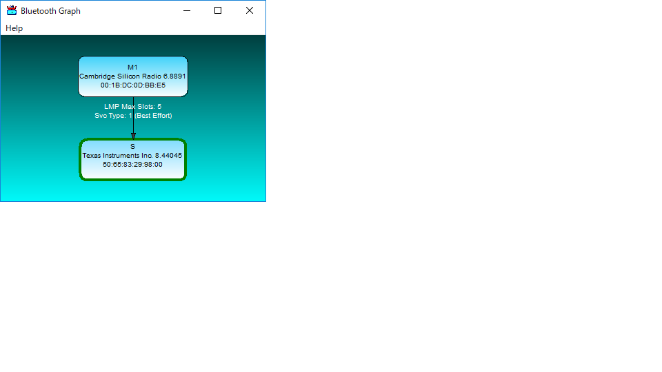

    We got data with the suggested Logger application. (Measurement conditions are same as last time)
    H/W TMDXEVM3358 + WL1835MODCOM8B(BT-DBG port)
        Line 1-10228 Preconfiguration and Bluetooth session establishment.
        Line 10299 Start TCP Bench mark test.
        Line 12283 TCP benchmark software communication error occurred (simultaneous ping communication became impossible at the same time)
        Line 24687 WL1835 device power off ( No reboot linux)
        Line 24689  WL1835 device power on
        Line 24693  prepare and establish BT connection.
    > Additionally, if you have a Bluetooth sniffer (i.e. frontline or ellisys), the sniffer logs in conjunction with the BT FW logs will be helpful as well.
    We are sorry, we do not have a Bluetooth sniffer, so we can not monitor it.
    Please check the attached log file.
    kikuchi
    20180109_PowerOn_to_login_PAN_stop.zip
  • Vihang-san.
    I am sorry.
    I made a mistake in setting the log tool. (ili setting) So.
    21:29:52 - 21:29:57  Linux kernel booting
    21:31:47 - 21:31:58  PANM>SetDevicePower 1 ( TIInit_11.8.32.bts. )
    21:32:38 - 21:32:40  PANM>ConnectRemoteServer 001bdc0dbbe5 1 1 0x3
    21:35:00                    TCP Benchmark Soft (Heavy load to 3Mbps BT line)
    21:35:10                    IP hung up detect. ( No response TCP & ICMP)
    kikuchi
    20180130_BTPAN_stopped.zip

    (1) ‐Linux Processor SDK for AM335x 4.01.00.06 & ‐TI Bluetooth Stack version 4.2.1.0.1.0
    (2) ‐Linux Processor SDK for AM335x 3.01.00.06 & ‐TI Bluetooth Stack version 4.2.1.0.1.0
    In either case, if load is imposed by iperf, communication stops.
    Could you check the load test by using iperf etc. and confirm whether to reproduce it?
    P.S.
    SS1VNET.ko compiled according to each SDK environment is used.
    kikuchi
  • Hi Hari san
    As usual the problem is not solved.
    Problems also occur with flood ping and iperf.
    kikuchi
  • Hi Hari san.
    I send flood ping log.
    12:01:00 EVM Power ON
    12:03:30 PANM> setDevicePower ON
    12:05:00 PANM> connectRemoteServer
    12:05:00 ifconfig ss1vnet0 inet 169.254.2.171
    12:07:00 flood ping (from windows side) start
    12:08:30 WL18xx hung up detect.
    Check it please.
    kikuchi
    1738.20180309_BTPAN_stopped.zip
