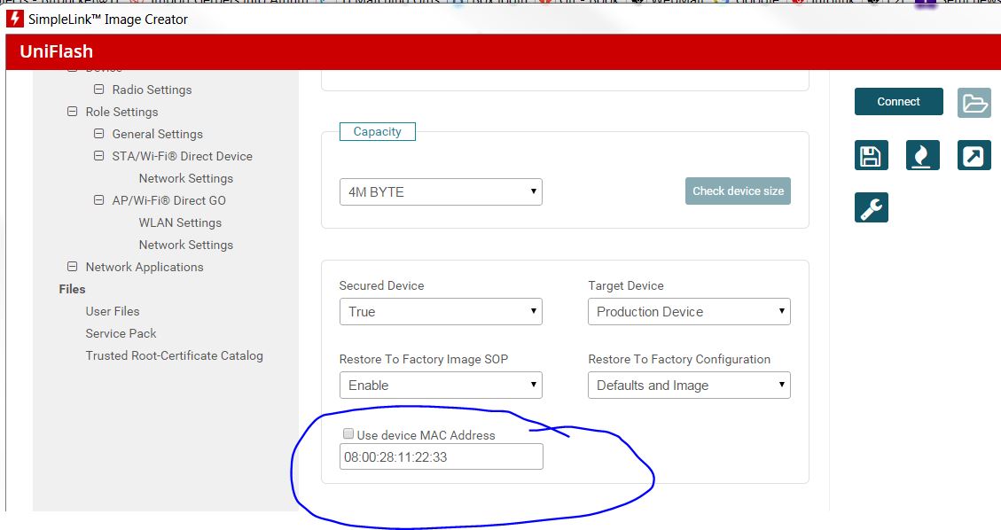

  • Hi I'm still stuck on this. I can program our H/W using the CLI over UART, but its very inconvenient. The main inconvenience is that I have to update the MAC address of my image for each unit I program and reading the MAC address is a manual process or using CLI, then copy-pasting into the GUI to recreate the image.
    If I can't use the Uniflash GUI to directly program CC3220 SPI Flash on custom H/W, then can someone show me how to use CLI to replicate the "Use Device Mac Address" feature of the GUI? This feature reads the MAC address from the H/W and automatically includes it in the created image of the "Create & Program" operation. See attached screenshot showing the feature I'm asking about.

    What does Uniflash do when you try to connect to your board? does it immediately tell you it times out, or does it take ~10 seconds? Regarding the MAC Address, if you are creating a production image you shouldn't need the MAC Address to be specified. Try creating a new project that is in production mode and recreating the SLI.
    This worked perfectly. Thanks! I don't have any need for the GUI connect feature now.
