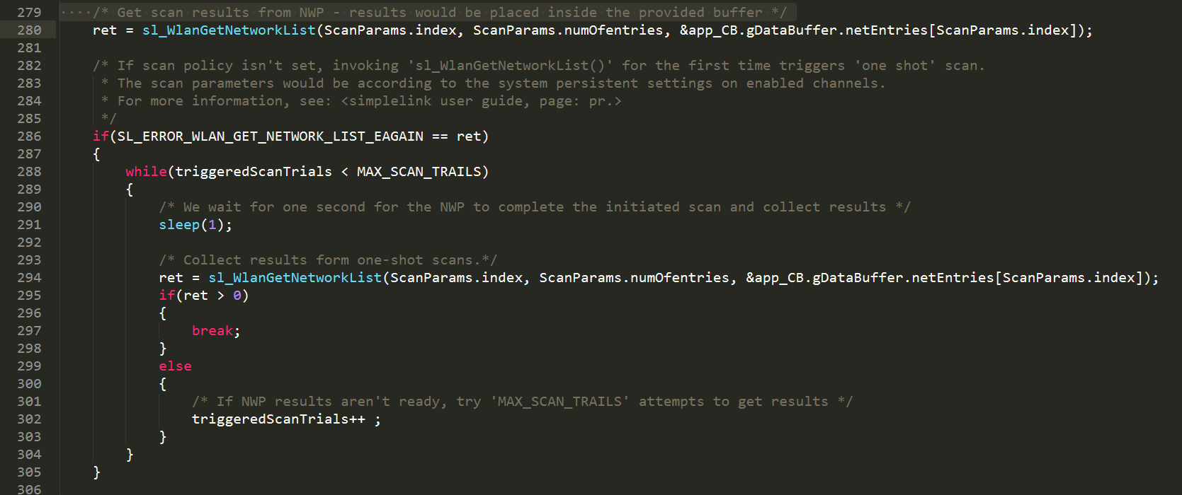

    I found below code in cmdScanCallback.
    Is this the code clearing an old entries ?
        /* Clear the results buffer */
        memset(&app_CB.gDataBuffer, 0x0, sizeof(app_CB.gDataBuffer));
    Thanks and regards,
    KoT
  • Yes I would assume so. It is setting the memory at gDataBuffer address to zeroes.
    Did this work for you?
    VR

    I tried network terminal demo and found below results.
    a) If the “scan” command (ex. “scan –n 30”) is used repeatedly, an old entry remains in the list even after the AP is actually OFF.
    b) If a new AP is turned ON during a) process, the AP list is updated and the new AP is added to the list.
    c) After “setpolicy” command (ex. “setpolicy –i 10”) is used, the AP list seems to be updated based on interval (10 second in this case).
    Please see the log. “tested AP” is the AP which is manually turned ON and OFF.

    According to Network Terminal demo document, Scan command supports two modes (“one shot” and “background”).
    C:\ti\simplelink_cc32xx_sdk_1_60_00_04\examples\rtos\CC3220SF_LAUNCHXL\demos\network_terminal\README.html
    I understood, “one shot” is used during a) and b). Then mode is changed to “background” in c). This is why table is updated properly.
    But it is not clear for me why a new AP is detected during “one shot” operation. Is this expected behavior?
    Thanks and regards,
    KoT
  • KoT,
    Yes this is expected Behavior. When using one shot mode, you will cal lsl_getNetworkEntries() to start the scan, then call sl_getNetworkEntries() to get the entries.
    In the network terminal example, when you do a one shot it does these two steps, and thus will return the APs it  sees during that scan.
    Please see below code snippet from the Network Terminal example in the wlan_cmd.c
  • Hi VR,
    So sl_getNetworkEntries() is called twice and AP list is updated at the second call in one shot mode.
    I think this is the case in “network_terminal_log.txt” line#52 to line#72.
    (please refer to the log I attached previous post)
    AP list is updated and “tested AP” (and other APs) are added.
    But at line#101 and after, AP list does not seem to be updated.
    The list is the same. Why?
    Thanks and regards,
    KoT
