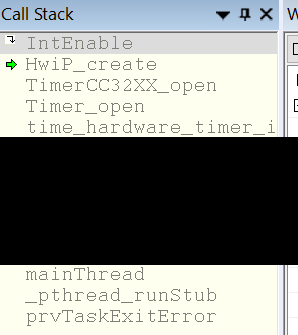

  • Hi Austin,
    Just a little update, in a debug session I managed to get the call stack in which case it seems to lead to a ISR fault :
    For now I don't know what does IntEnable() do because the source code is not compiled in my IAR project.
    Apart from that, nothing changed, the fault appears only after a first successful debug session. Like before, if I unplug and then replug the board, it will run as expected.
