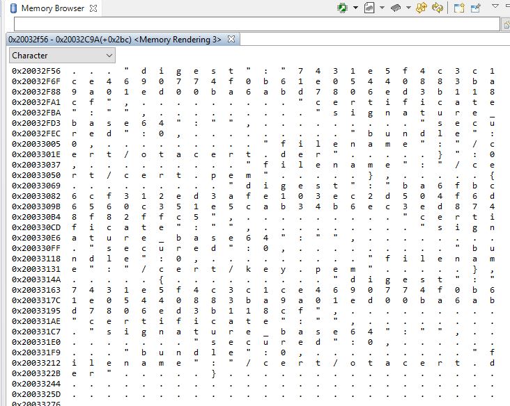

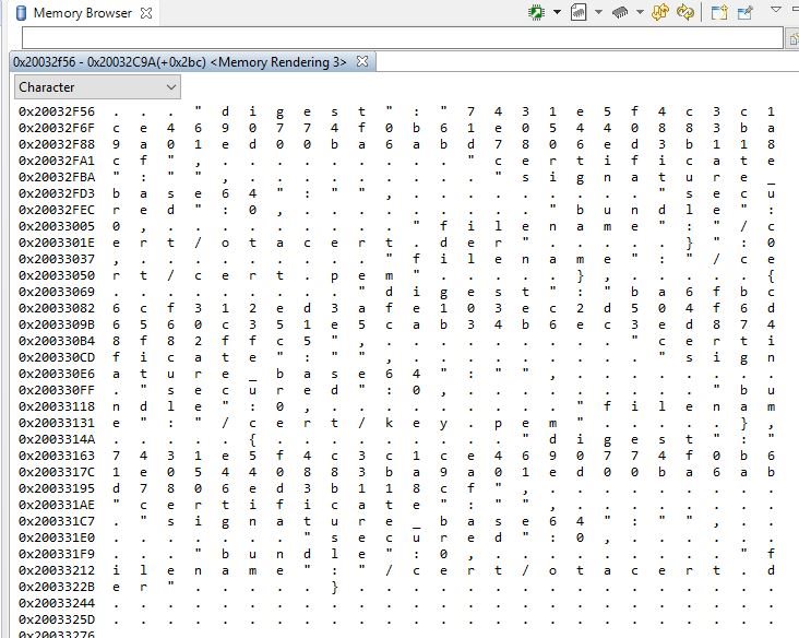

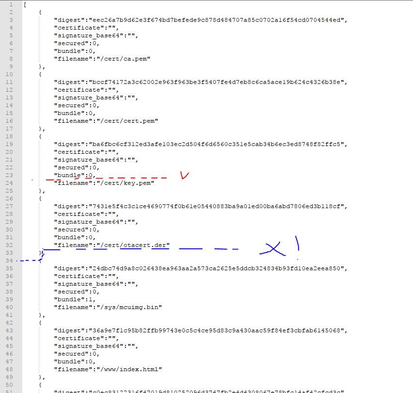

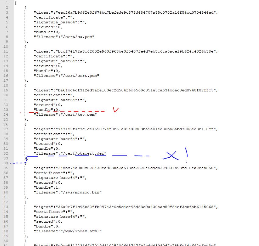

In OtaArchive.c in the state ARCHIVE_STATE_PARSE_CMD_FILE, the cmd file is parsed, and the function _BundleCmdFile_Parse is expected to return whether the full file is parsed or not.
The function however does not always work correctly. I just so happened to have bad luck, and my buffer just was split in the worst possible place. Trying to visualize here:
As you can see, the entire json object was accidentally cut -just- after the }, and this causes the parsing function to wrongly report being done with the entire file..
The correct way of checking whether the entire ota file is parsed, is to pass it the length stored in the tar header..
