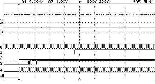

Once again trying to get a custom module with WL1837MOD working, now that the new hardware came in.
I am using BeagleBone Black as the reference platform.  We took a board we designed previously for testing which was able to operate properly at reduced MMC clock speed.  The main difference between the new board and the one we were able to make work is in the voltage regulators (for 3.3V and 1.8V).  The previous design has onboard regulators similar to TI reference designs, whereas the new board is relying on off-board regulators...in fact both the 3.3V and the 1.8V supplies for the WL1837MOD are coming straight off the TPS65217C in the new design (LS2_OUT and LS1_OUT, respectively).
I have verified the BUF_ENABLE and WLAN_EN are matching the same startup sequence for both the reference board (the element14 WiFi cape) and our new board.  However, on the working reference board, the WLAN_IRQ signal goes low about 19ms after the WLAN_EN goes high.  But on our board, the WLAN_IRQ stays high indefinitely.

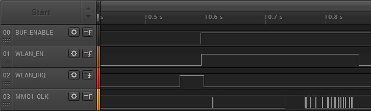

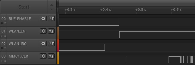

It seems like the WLAN_IRQ goes low on its own...that it doesn't require any MMC/SDIO transactions to make it go low initially.  What could cause the WLAN_IRQ to stay high on initial power up?
Working Reference Board:
Failing Board:
  • FYI, today I hacked in the discrete regulators from the previous design. They are measuring good voltage at the new module, but we still have the same WLAN_IRQ signal stuck high after WLAN_EN is enabled. So I don't believe it's simply a voltage regulation issue.
  • David , Are you booting WiLink8MOD in debug mode or operational mode ? Pls check 'sense on reset' section of www.ti.com/.../swru437.pdf . WLAN_IRQ should be low before WLAN_EN is asserted for it to boot in operational mode.

  • Hi David,
    Lets ensure that you have the proper start up sequence. In the new design is VBAT and VIO up and stable before WLAN_EN is asserted? Also is the slow clock on and stable? this is a requirement.
    I suggest you add the VBAT, VIO and slow clock to the plots above. This will be telling as to what is going on with WLAN_IRQ.
    The proper sequence is shown on page 22 of the datasheet (figure 5-2). This timing needs to be validated to ensure proper startup.
    My guess is that it is related to timing as the reference works, but modifying the supplies causes an issue on the new design. Also I would check to ensure that new supplies from a current point of view are sized appropriately.

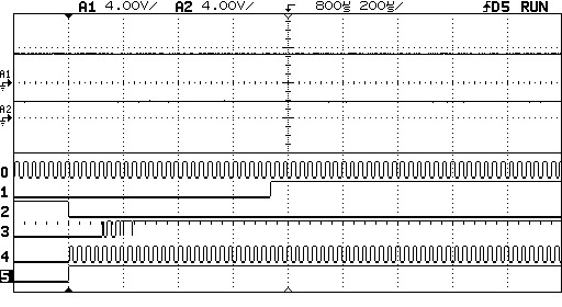

  • You guys are making me get out the big scope :).  I will get the requested additional IO lines captured tomorrow, and compare again against the power up sequencing which I have already reviewed.
    We are only attempting to use normal operating mode.  We are relying on the indicated internal pullup/pulldown resistors (within the WL1837MOD) to enter this mode.  My understanding is normal operating mode is not dependent on the WLAN_EN control, but rather the power-up state which should be the default since the level translator should be disabled initially (I will check on this point also tomorrow morning, but it's the same BBB driving the same line on both boards).
    As you can see, the "working" board also has the WLAN_IRQ HIGH when WLAN_EN is enabled, as in the BBB + Element14 reference design.  Note that in the e14 design, the WLAN_IRQ is set high prior to enabling the level shifters due to the internal pullup in the CPU side (I am measuring the 3.3V side of the level shifter).  I'm not sure if there's a good point to measure the 1.8V side of the WLAN_IRQ (I don't have layout files for the e14 board).  This line was high on our board on the 1.8V side, even with the level translator disabled, and we have no external pullup on the 1.8V side.

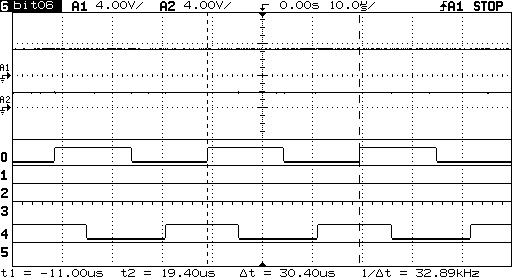

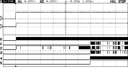

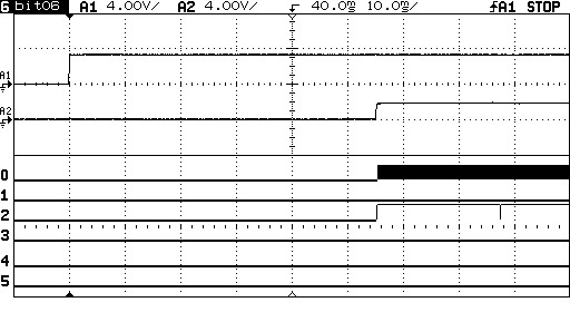

  • I have taken some captures from the board with the add-on voltage regulators (these regulators are the same as used in the reference design, TPS73618DBVR and TL1936A-33DCYR).
    The screen grabs are a bit archaic, but here is the signal key:
    A1 - 3.3V (VBAT)
    A2 - 1.8V (VIO)
    0 - SLOW_CLK
    1 - WLAN_EN
    2 - SDIO_CLK
    3 - WLAN_IRQ
    4 - BT_AUD_OUT
    5 - BUF_ENABLE
    The digital signals are all taken from the 1.8V side of the level translator.
    I cannot tap the BT_UART_DBG pin...this is not connected on our board.
    Some measurements that are difficult to show:
    Time between 3.3V and 1.8V up: ~55ms.
    SLOW_CLK is on as soon as 1.8V supply is up.
    SDIO_CLK is HIGH as soon as 1.8V supply is up (there are 10K pullup resistors on the SDIO bus lines on the 1.8V side).
    Time between BUF_ENABLE and WLAN_EN high: ~736us.
    SLOW_CLK frequency is about 32.8 kHz.  The part used is Abracon ASEK-32.768KHz-LRT.
    It seems the BT_AUD_OUT is oscillating from the BBB side. In the e14 reference design, they are using that signal for the slow clock. Could that be interfering with the bootup mode in this case?  I could disable this in the BBB DTS (but my platform does not do this).
    It also appears my digital probes (WLAN_EN and WLAN_IRQ) are picking up noise from other probes.  I could tap these with the analog probes if it would be helpful.
    Initial Power Up, from VBAT high through initial sequence:
    Closeup of VBAT to VIO:
    Closeup of SLOW_CLK:
    Closeup when BUF_ENABLE is activated:
  • Based on the HW integration guide, it seems the BT_AUD_OUT and WLAN_IRQ should be LOW whenever the WLAN_EN is first asserted. Perhaps this is caused by the BT_AUD_OUT...I will see if I can disable the clock output on that IO and see if it makes a difference.
  • I disconnected the BT_AUD_OUT from the CPU side to rule it out. No change. Any other ideas?
  • I noticed the only difference between the 2 startup modes (normal and debug) is the WL_IRQ pin...whether it is pulled up or not. I think it shouldn't matter the pullup state on the IRQ...the WL1837MOD should start up either way, assuming the BT_AUD_OUT and BT_UART_DBG are also in the proper states.
    It seems the working reference board I have has a 10K pullup on the WLAN_IRQ on the 1.8V side. I can see if I can install a 10K resistor on our board (we have a pad for it, just marked it do not populate).
  • David,
    For WiLink8 to boot up in operational mode WLAN_IRQ level should be low - "IRQ_WL = 0, UART_DBG_BT = 1, AUD_OUT_BT = 0" . 10k pull up on WLAN_IRQ will be needed in case you want it to boot in debug mode.
    For power up/down sequence pls check section 5.21.2 of www.ti.com/.../wl1837mod.pdf. Make sure VBAT,VIO and slow clock are stable before WLAN_EN is asserted
    Is BT_EN low at all times ? What issue do you see if failing scenario ? You mentioned you had to reduce SDIO clk to get it working on functional board - can you please explain why you had to reduce SDIO clk
