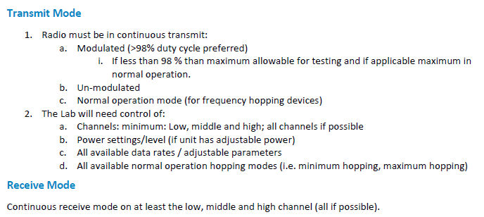

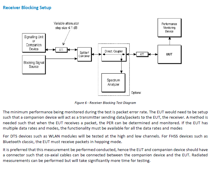

We need to do our FCC testing soon and we are having a hard time with figuring out how to use the calibrator tool described here:
http://processors.wiki.ti.com/index.php/WL18xx_TX_Testing
We are using only the Bluetooth LE portion of the module and need to know what calibrator commands to issue to get the device into the following modes:
