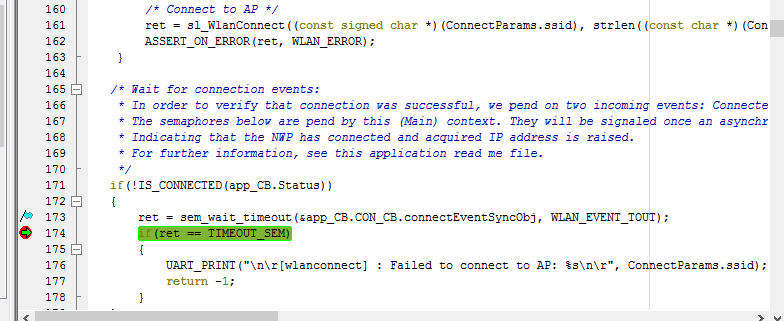

I'm using network terminal project, my step is as below:
1. connect an AP use wlanconnect command
2. power down my AP, it will print the message  Device disconnected from the AP: LMServerAP
3. connect the AP again, it will reach line 174(code after sem_wait_timeout) at the picture below immediately , but now timeout(it is 6 seconds) is not reached, and  sem_post(&app_CB.CON_CB.connectEventSyncObj); also has not been done,
why it can go ahead and not block in sem_wait_timeout.
The first time I connect the AP it worked normally, it will sem_post firstly then unblock the sem_wait_timeout! But once I connected AP and restart the AP , connect the AP again, the phenomenon will occur!

    the function sem_wait_timeout is designed as below, it do not use the sem_getvalue, I'm not sure if something wrong with function sem_wait_timeout
    int32_t sem_wait_timeout(sem_t *sem, uint32_t Timeout)
    struct timespec abstime;
    abstime.tv_nsec = 0 ;
    abstime.tv_sec = 0 ;
    /* Since POSIX timeout are relative and not absolute,
    * take the current timestamp. */
    clock_gettime(CLOCK_REALTIME, &abstime);
    if ( abstime.tv_nsec < 0 )
    abstime.tv_sec = Timeout;
    return (sem_timedwait(sem , &abstime));
    /* Add the amount of time to wait */
    abstime.tv_sec += Timeout / 1000 ;
    abstime.tv_nsec += (Timeout % 1000)*1000000;
    abstime.tv_sec += (abstime.tv_nsec / 1000000000);
    abstime.tv_nsec = abstime.tv_nsec % 1000000000;
    /* Call the semaphore wait API */
    return sem_timedwait(sem , &abstime);

  • Yes, I really can get semaphore posted to again from the callback. But what confused me is it jump over the sem_wait_timeout immediately when I call wlanconnect command(now the post do not happened yet). Wait a short time, the semaphore will post when the SL_WLAN_EVENT_CONNECT happened.
  • I input the wlanconnect command again, I not use the device automatically connect to the AP

    I performed the following test and found no issue:
    1. Run Network Terminal example
    2. Call wlanconnect to a known AP (successfully connected)
    3. Power down the AP to cause a disconnect event
    4. Call wlanconnect on an AP that does NOT exist to cause the system to wait at the "sem_wait_timeout()" call in cmdWlanConnectCallback.
    The system stays at the sem_wait_timeout call for the appropriate amount of time before timing out. When I perform step (4) with the original AP, I also wait as expected until I see the SL_WLAN_EVENT_CONNECT event which causes the sem_post().
    Do you have any more details on your test that I could be missing in mine?
