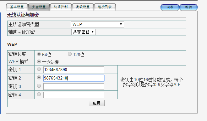

CC3220S-LAUNCHXL: How to set the WEP index when connect an AP with WEP security? Some AP can choose a key within 4 group, does CC3220S use defaulte index 1 to connect the AP?
Part Number: CC3220S-LAUNCHXL
seems in struct SlWlanSecParams_t do not have the parameter WEP index in sl_WlanConnect(const _i8*  pName,const  _i16 NameLen,const _u8 *pMacAddr,const SlWlanSecParams_t* pSecParams ,const SlWlanSecParamsExt_t* pSecExtParams);

Some AP can set the WEP index like the picture below:
  • Hi Xiaozhong Zhang,
    WEP is a very insecure protocol. It would be wise to move to a newer, more secure, protocol.
    I believe this function is carried out by your router for the most part since it can only use one index at a time. I think the user chooses which index (or key) its router will look for during authentication.
