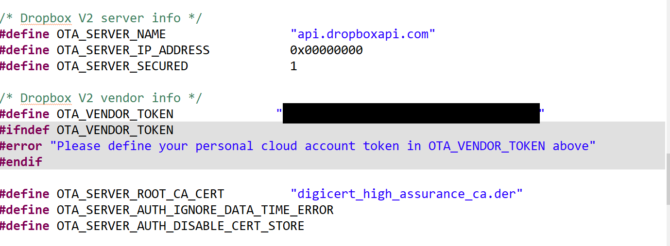

    I authorized the app and insert all the data needed as below:
    But still Receiving "OtaRunStep: WARNING Ota_run, Status=20006, continue for next OTA retry" on the terminal and OTA is not completed!
  • Hi Adham,
    The parameters you show here (from ota user.h) relates to a Dropbox configuration.
    On the top of the file you should define the server you are connecting to. Please choose the github definition (which is your target if I understand correctly) and fill the github specific configuration.

  • Hi Kobi,
    Thank you for you assistance.
    Sorry the first log was for GitHub (we decided later to work with dropbox)
    The definition for the GitHub server is set in the code :
    #define OTA_SERVER_TYPE OTA_SERVER_DROPBOX_V2

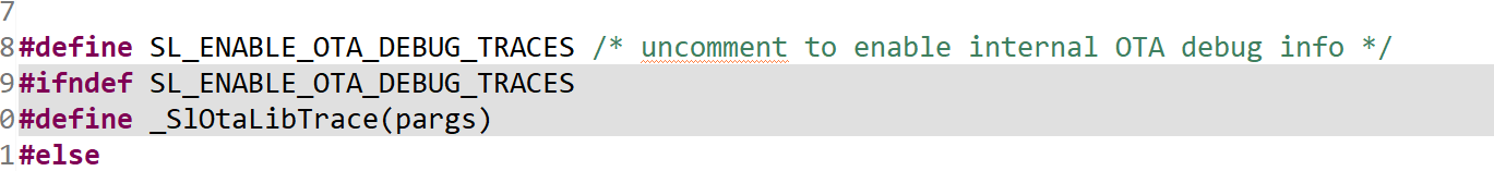

  • Hi Adham,
    Please enable the OTA library trace (SL_ENABLE_OTA_DEBUG_TRACES in otauser.h). You'll need to recompile the library and application.
    This will add required debug information.
    br,
    Kobi
  • Hi Kobi,
    This defined is enabled. and the previous log was from that code.
  • The log doesn't show the OTA library trace.
    Probably, you are not linking the application with the library.
    Make sure the new compiled library (ota.a) is included in the  "Project Properties -> Build -> Arm Linker -> File Search Path".
    Check if the library is built within the SDK or in your workspace folder.
    Br,
    Kobi
  • Hi Kobi,
    You are right that was one problem. and now I'm receiving the full log from the development kit. another issue was that the "DigCert_High_Assurance_CA" file name was different from the file in the uniflash.
    Thank you for your help ans assistance.
