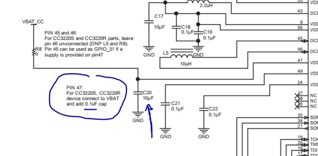

CC3220: VDD-ANA2 pin use
Part Number: CC3220
I am using the CC3220S and find conflicting info on the datasheet, it says to DNP R8 which means no need to connect pin 47 to VCC.
My prototypes are using pin 47 floating (just decouple cap) without issues. Is the VCC connection needed? If so, why?
Thanks, Tom
