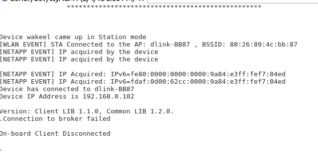

I've been trying to connect to a local ipv6 mqtt broker .Already changed the MQTTClient_NetAppConnParams_t parameters to MQTTCLIENT_NETCONN_IP6, yet still get Connection to broker failed.
  • Hi Wakeel,
    Please share which server you are using and the print out when using IPv4.
    Ben M
  • I'm using mosquitto on a raspberry pi as server.I will have the print out for ipv4 tomorrow.
    Here are my codes :

    //! \return     None
    void SimpleLinkNetAppRequestHandler(SlNetAppRequest_t *pNetAppRequest, SlNetAppResponse_t *pNetAppResponse)
        /* Unused in this application                                             */
    //! This function handles HTTP server events
    //! \param[in]  pServerEvent     - Contains the relevant event information
    //! \param[in]  pServerResponse  - Should be filled by the user with the
    //!                                relevant response information
    //! \return None
    void SimpleLinkHttpServerCallback(SlNetAppHttpServerEvent_t *pHttpEvent, SlNetAppHttpServerResponse_t *pHttpResponse)
    //! This function handles General Events
    //! \param[in]  pDevEvent - Pointer to General Event Info
    //! \return None
    void SimpleLinkGeneralEventHandler(SlDeviceEvent_t *pDevEvent)
        /* Most of the general errors are not FATAL. are to be handled            */
        /* appropriately by the application.                                      */
        UART_PRINT("[GENERAL EVENT] - ID=[%d] Sender=[%d]\n\n", pDevEvent->Data.Error.Code, pDevEvent->Data.Error.Source);
    //! This function handles socket events indication
    //! \param[in]  pSock - Pointer to Socket Event Info
    //! \return None
    void SimpleLinkSockEventHandler(SlSockEvent_t *pSock)
        /* This application doesn't work w/ socket - Events are not expected      */
        switch (pSock->Event)
            case SL_SOCKET_TX_FAILED_EVENT:
                switch (pSock->SocketAsyncEvent.SockTxFailData.Status)
                    case SL_ERROR_BSD_ECLOSE:
                        UART_PRINT("[SOCK ERROR] - close socket (%d) operation "
                                "failed to transmit all queued packets\n\r", pSock->SocketAsyncEvent.SockTxFailData.Sd);
                        break;
                    default:
                        UART_PRINT("[SOCK ERROR] - TX FAILED  :  socket %d , "
                                "reason (%d) \n\n", pSock->SocketAsyncEvent.SockTxFailData.Sd, pSock->SocketAsyncEvent.SockTxFailData.Status);
                        break;
                break;
            default:
                UART_PRINT("[SOCK EVENT] - Unexpected Event [%x0x]\n\n", pSock->Event);
                break;
    // SimpleLink Asynchronous Event Handlers -- End
    //! This function initializes the application variables
    //! \param  None
    //! \return 0 on success, negative error-code on error
    void InitializeAppVariables(void)
        g_ulStatus = 0;
        g_ulStaIp = 0;
        g_ulGatewayIP = 0;
        memset(g_ucConnectionSSID, 0, sizeof(g_ucConnectionSSID));
        memset(g_ucConnectionBSSID, 0, sizeof(g_ucConnectionBSSID));
    //! The function initializes a CC3220 device and triggers it to start operation
    //! \param[in]  uiMode  - device mode in which device will be configured
    //! \return 0 : success, -ve : failure
    long Network_IF_InitDriver(uint32_t uiMode)
        long lRetVal = -1;
        /* Reset CC3220 Network State Machine                                     */
        InitializeAppVariables();
        /* Following function configure the device to default state by cleaning   */
        /* the persistent settings stored in NVMEM (viz. connection profiles      */
        /* & policies, power policy etc) Applications may choose to skip this     */
        /* step if the developer is sure that the device is in its default state  */
        /* at start of application. Note that all profiles and persistent         */
        /* settings that were done on the device will be lost.                    */
        lRetVal = sl_Start(NULL, NULL, NULL);
        if (lRetVal < 0)
            UART_PRINT("Failed to start the device \n\r");
            LOOP_FOREVER();
        switch (lRetVal)
            case ROLE_STA:
                UART_PRINT("Device wakeel came up in Station mode\n\r");
                break;
            case ROLE_AP:
                UART_PRINT("Device came up in Access-Point mode\n\r");
                break;
            case ROLE_P2P:
                UART_PRINT("Device came up in P2P mode\n\r");
                break;
            default:
                UART_PRINT("Error:unknown mode\n\r");
                break;
        if (uiMode != lRetVal)
            UART_PRINT("Switching Networking mode on application request\n\r");
            /* Switch to AP role and restart                                      */
            lRetVal = sl_WlanSetMode(uiMode);
            ASSERT_ON_ERROR(lRetVal);
            lRetVal = sl_Stop(0xFF);
            lRetVal = sl_Start(0, 0, 0);
            if (lRetVal == uiMode)
                switch (lRetVal)
                    case ROLE_STA:
                        UART_PRINT("Device came up in Station mode\n\r");
                        break;
                    case ROLE_AP:
                        /* If the device is in AP mode, we need to wait for this  */
                        /* event before doing anything.                           */
                        while (!IS_IP_ACQUIRED(g_ulStatus))
                            usleep(1000);
                        break;
                    case ROLE_P2P:
                        break;
                    default:
                        break;
            else
                UART_PRINT("could not configure correct networking mode\n\r");
                LOOP_FOREVER();
        else
            if (lRetVal == ROLE_AP)
                    usleep(1000);
        return 0;
    //! The function de-initializes a CC3220 device
    //! \param  None
    //! \return On success, zero is returned. On error, other
    long Network_IF_DeInitDriver(void)
        long lRetVal = -1;
        UART_PRINT("SL Disconnect...\n\r");
        /* Disconnect from the AP                                                 */
        lRetVal = Network_IF_DisconnectFromAP();
        /* Stop the simplelink host                                               */
        sl_Stop(SL_STOP_TIMEOUT);
        /* Reset the state to uninitialized                                       */
        Network_IF_ResetMCUStateMachine();
        return lRetVal;
    //! Connect to an Access Point using the specified SSID
    //! \param[in]  pcSsid          - is a string of the AP's SSID
    //! \param[in]  SecurityParams  - is Security parameter for AP
    //! \return On success, zero is returned. On error, -ve value is returned
    long Network_IF_ConnectAP(char *pcSsid, SlWlanSecParams_t SecurityParams)
        char acCmdStore[128];
        unsigned short usConnTimeout;
        unsigned char ucRecvdAPDetails;
        long lRetVal;
        uint32_t  ulIP = 0;
        uint32_t  ulIP6 = 0;
        unsigned long ulSubMask = 0;
        unsigned long ulDefGateway = 0;
        unsigned long ulDns = 0;
        unsigned long ulDns2 = 0;
        g_usConnectIndex = 0;
        CLR_STATUS_BIT(g_ulStatus, STATUS_BIT_CONNECTION);
        CLR_STATUS_BIT(g_ulStatus, STATUS_BIT_IP_ACQUIRED);
        /* Continue only if SSID is not empty                                     */
        if (pcSsid != NULL)
            /* This triggers the CC3220 to connect to a specific AP.              */
            lRetVal = sl_WlanConnect((signed char *) pcSsid, strlen((const char *) pcSsid),
            NULL, &SecurityParams, NULL);
            /* Wait for ~10 sec to check if connection to desire AP succeeds      */
            while (g_usConnectIndex < 10)
                sleep(1);
                if (IS_CONNECTED(g_ulStatus) && IS_IP_ACQUIRED(g_ulStatus) && IS_IP6_ACQUIRED(g_ulStatus))
                    break;
                if (IS_CONNECTED(g_ulStatus) && IS_IPV6G_ACQUIRED(g_ulStatus))
                    break;
                if( IS_IPV6G_ACQUIRED(g_ulStatus) && IS_IPV6L_ACQUIRED(g_ulStatus) && IS_IP_ACQUIRED(g_ulStatus))
                    break;
                g_usConnectIndex++;
        else
            UART_PRINT("Empty SSID, Could not connect\n\r");
            return -1;
        /* Check and loop until AP connection successful, else ask new AP SSID    */
        while (!(IS_CONNECTED(g_ulStatus)) || !(IS_IP_ACQUIRED(g_ulStatus)))
            /* Disconnect the previous attempt                                    */
            UART_PRINT("Device could not connect to %s\n\r", pcSsid);
            do
                ucRecvdAPDetails = 0;
                UART_PRINT("\n\r\n\rPlease enter the AP(open) SSID name # ");
                /* Get the AP name to connect over the UART                       */
                lRetVal = GetCmd(acCmdStore, sizeof(acCmdStore));
                if (lRetVal > 0)
                    /* remove start/end spaces if any                             */
                    lRetVal = TrimSpace(acCmdStore);
                    if (lRetVal)
                        /* Parse the AP name                                          */
                        strncpy(pcSsid, acCmdStore, lRetVal);
                        if (pcSsid != NULL)
                            ucRecvdAPDetails = 1;
                            pcSsid[lRetVal] = '\0';
            } while (ucRecvdAPDetails == 0);
            /* Set Security Parameters to OPEN security type.                     */
            SecurityParams.Key = (signed char *) "";
            SecurityParams.KeyLen = 0;
            SecurityParams.Type = SL_WLAN_SEC_TYPE_OPEN;
            UART_PRINT("\n\rTrying to connect to AP: %s ...\n\r", pcSsid);
            /* Get the current timer tick and setup the timeout accordingly.      */
            usConnTimeout = g_usConnectIndex + 15;
            /* This triggers the CC3220 to connect to specific AP.                */
                                      NULL, &SecurityParams,NULL);
            /* Wait ~10 sec to check if connection to specified AP succeeds       */
                sleep(1);
                if (g_usConnectIndex >= usConnTimeout)
                    break;
                g_usConnectIndex++;
        /* Put message on UART                                                    */
        UART_PRINT("\n\rDevice has connected to %s\n\r", pcSsid);
        /* Get IP address                                                         */
    //    lRetVal = Network_IF_IpConfigGet(&ulIP, &ulSubMask, &ulDefGateway, &ulDns);
    //    ASSERT_ON_ERROR(lRetVal);
        //ulIP=app_CB.CON_CB.Ipv6Addr;
        lRetVal = Network_IF_Ip6ConfigGet(&ulIP6, &ulDns2);
       //ASSERT_ON_ERROR(lRetVal);
        /* Send the information                                                   */
        UART_PRINT("Device IP Address is %d.%d.%d.%d \n\r\n\r", SL_IPV4_BYTE(ulIP, 3), SL_IPV4_BYTE(ulIP, 2), SL_IPV4_BYTE(ulIP, 1), SL_IPV4_BYTE(ulIP, 0));
        return 0;
    //! Disconnects from an Access Point
    //! \param  none
    //! \return 0 disconnected done, other already disconnected
    long Network_IF_DisconnectFromAP(void)
        long lRetVal = 0;
        if (IS_CONNECTED(g_ulStatus))
            lRetVal = sl_WlanDisconnect();
            if (0 == lRetVal)
                while (IS_CONNECTED(g_ulStatus))
                    usleep(1000);
                return lRetVal;
            else
                return lRetVal;
        else
            return lRetVal;
    //! Get the IP Address of the device.
    //! \param[in]  pulIP               - IP Address of Device
    //! \param[in]  pulSubnetMask       - Subnetmask of Device
    //! \param[in]  pulDefaultGateway   - Default Gateway value
    //! \param[in]  pulDNSServer        - DNS Server
    //! \return On success, zero is returned. On error, -1 is returned
    long Network_IF_IpConfigGet(unsigned long *pulIP, unsigned long *pulSubnetMask, unsigned long *pulDefaultGateway, unsigned long *pulDNSServer)
        unsigned short usDHCP = 0;
        long lRetVal = -1;
        unsigned short len = sizeof(SlNetCfgIpV4Args_t);
        SlNetCfgIpV4Args_t ipV4 = { 0 };
        /* get network configuration                                              */
        lRetVal = sl_NetCfgGet(SL_NETCFG_IPV4_STA_ADDR_MODE, &usDHCP, &len, (unsigned char *) &ipV4);
        *pulIP = ipV4.Ip;
        *pulSubnetMask = ipV4.IpMask;
        *pulDefaultGateway = ipV4.IpGateway;
        *pulDefaultGateway = ipV4.IpDnsServer;
        return lRetVal;
    long Network_IF_Ip6ConfigGet(unsigned long *pulIP, unsigned long *pulDNS)
        long lRetVal = -1;
        SlNetCfgIpV6Args_t ipV6={ 0 };
        _u16 len = sizeof(SlNetCfgIpV6Args_t);
        _u16 ConfigOpt = 0;  //return value could be one of the following: SL_NETCFG_ADDR_STATIC / SL_NETCFG_ADDR_STATELESS / SL_NETCFG_ADDR_STATEFUL
        lRetVal=sl_NetCfgGet(SL_NETCFG_IPV6_ADDR_LOCAL,&ConfigOpt,&len,(_u8 *)&ipV6);
        *pulIP = ipV6.Ip;
        *pulDNS = ipV6.IpDnsServer;
        if (SL_IS_IPV6_ADDR_VALID(ipV6.IpV6Flags))
            UART_PRINT("Ipv6 Local Address is valid: %8x:%8x:%8x:%8x\n", ipV6.Ip[0],ipV6.Ip[1],ipV6.Ip[2],ipV6.Ip[3]);
        else
            UART_PRINT("Ipv6 Local Address is not valid, wait for DAD to complete or configure a different address");
        return lRetVal;

     Application Name     -   MQTT Client
     Application Overview -   The device is running a MQTT client which is
                               connected to the online broker. Three LEDs on the
                               device can be controlled from a web client by
                               publishing msg on appropriate topics. Similarly,
                               message can be published on pre-configured topics
                               by pressing the switch buttons on the device.
     Application Details  - Refer to 'MQTT Client' README.html

    /* Defining Broker IP address and port Number                                 */
    //#define SERVER_ADDRESS           "messagesight.demos.ibm.com"
    #define SERVER_ADDRESS           "fdaf:d00:62cc:0:f1cd:c4b1:acf8:d39e"
    #define SERVER_IP_ADDRESS        "fdaf:d00:62cc:0:f1cd:c4b1:acf8:d39e"
    #define PORT_NUMBER              1883

    MQTTClient_NetAppConnParams_t Mqtt_ClientCtx =
        MQTTCLIENT_NETCONN_IP6 ,
        SERVER_ADDRESS,
        PORT_NUMBER, 0, 0, 0,
        NULL
    #endif

  • Hi Ben thanks for the reply I'm posting my codes for now and the print out using ipv4 tomorrow(cc3220sf currently at the university)
  • Thanks, I just want to make sure the connection is fine with IPv4.
    -Ben M
  • Hi Ben,
    the printout whn using ipv4
    thanks,Wakeel
  • Hi Ben,
    does the mqtt really work with ipv6?
    Need to submit my project next week and it does not connect to an ipv6 local broker even though it receives an address from my router and I'm able to ping it.
    Wakeel
  • Hi Wakeel,
    I believe I misunderstood your original question -> No, connecting to a server based on its address in IPv6 format is not currently supported by the library. However, using an IPv6 address as the client should be fine.
    Ben M
  • Hi Ben,
    will it be available in the future?
  • Hi Wakeel,
    You should be able to add this to the library if you need. The library is designed so that this can be added in the future.
    Ben M
