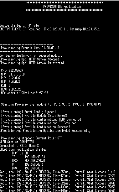

    Sorry it took me a while to get to this. I've messed around with the provisioning IOS App with a non-alpha password ==> "thewalou5%"
    I was unsuccessful in getting AP provisioning to work on the App, resulting in a failed connection. The terminal showed the following:
     Starting Provisioning! mode=2 (0-AP, 1-SC, 2-AP+SC, 3-AP+SC+WAC)
     [Provisioning] Profile Added: SSID: mySSID
     [Provisioning] Profile confirmation failed: Connection failed
    However, enabling Smart Config on the App lead to the provisioning being successful. The terminal showed the following:
    Can you try using Smart Config and using that for the time being? I'm not sure why AP mode is not working and will need to investigate this further.
    Let me know if you need any help with getting Smart Config to work.
    Hope this helps,
    Kevin
