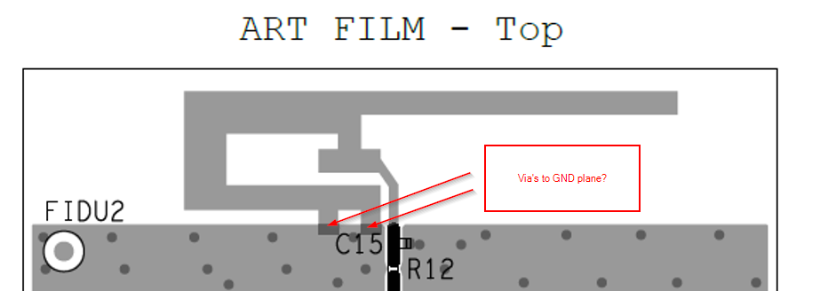

  • PM,
    I have a question about the reference design.
    See the image below. These two 'rectangles' at the end points of the arrows, are these via's connected to the ground plane? They seem to be, but I don't see any dimensions on how much they should overlap the plane etc. This is also not given in the inverted F antenna application note (and I have no tooling to open the correct reference design PCB files).
    Thank you in advance,
    Sven
    Yes, you can use Gnd Vias to connect it to the Ground Plane.
    You can use the Overlap size to the size of Via diameter ( 20 Mils or 40 Mils - not critical).
